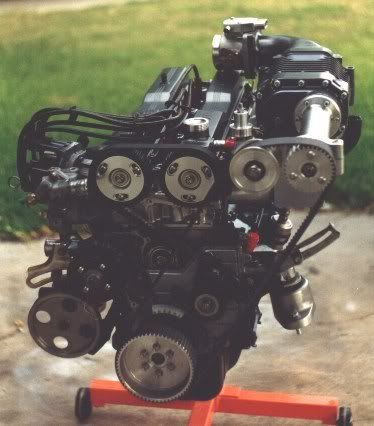

Second, you just had to mention 'M90', didn't you.......
Still have this stuck away in case I ever get tired of making NA HP:
Probably a good thing that this engine was never out into my first X8, as I have learned a lot in the past 15 years about keeping the 7M in one piece.

I didn't say no intercooler. I said no to old school roots blower water to air bullshit. Twin-screws can be intercooled like a turbo system, i.e. FMIC.

Sorry, I misunderstood.
I had thought about doing the same thing on mine, as the water to air unit I built into my 7M manifold is a piping nightmare, with a pump, reservoir, another heat exchanger out in front to cool the water anyway.
That shit is OK for a drag car where you can dump the hot water, and replace with ice chilled water after every one, but really impractical for anything else.
