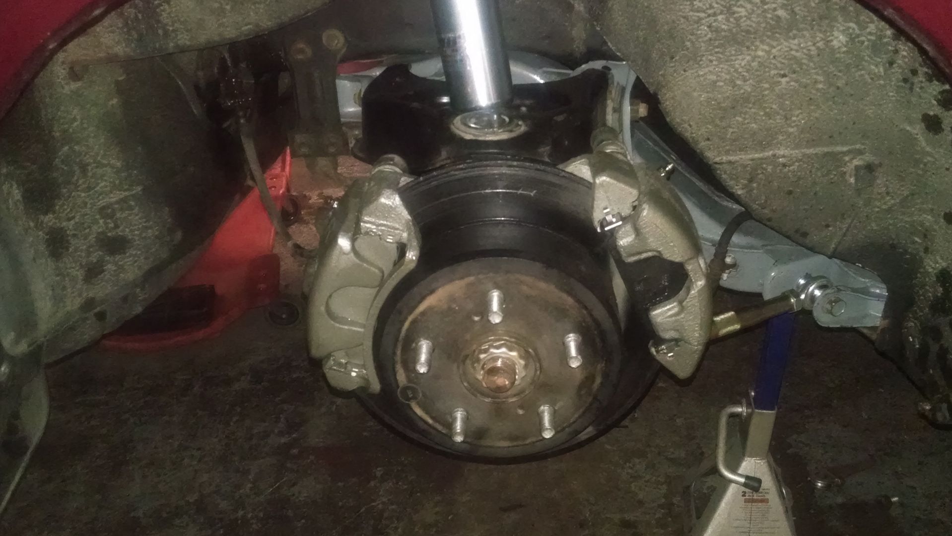

tuner4life 0 Report post Posted May 12, 2014 I picked up a known running 1994 1uz from a rear crashed sc400.. Also in the same trip I snagged a low mileage w58. 2 birds 1 midnight road trip. I'm going to do the timing belt, water pump, and basic seals/gaskets and call it a day.. I also finished up the front suspension. I was originally going to stick with the stock rack, but it ended up being trash and poured fluid out of both ends when I took the boots off. So I replaced it with a X7 rack, 1992 corolla inner tie rods, stock x8 outers. Along with the XM zero akerman arms, RCAs, and LCAs, the steering angle is pretty darn good. I'm happy with it. I feel bad for whoever has to align this thing though. And a picture after cleaning the area around the car for the first time all year. My wife freakin rocks and snagged the Mustang wheels for me at a yard sale for next to nothing.. I was kind of wanting 17"s, but these will work excellent for now. Tonight, I'll be working on reinstalling the stock sway bar and e brake stuff. Share this post Link to post Share on other sites
tuner4life 0 Report post Posted May 13, 2014 Stock paperclip status sway bar is back on and I finished up the rear brakes. The whole chassis is basically done now. The only things still to do is the drivetrain, and seats/belts. A roll cage will come later in the season, so I wont be able to tandem for a while.. Probably not a horrible thing anyways just yet anyways. Share this post Link to post Share on other sites
