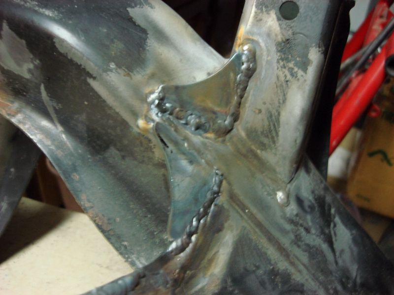

Gordo 0 Report post Posted April 15, 2013 Well, after a full 125cf bottle of argon, I am just about done. (as in had my fill of this fucking welding bull shit) Front & rear plates are on Cross tube in front crossmember fully seam welded 10 gussets in Doubled the amount of weld where for the front diff mount pocket in the front crossmember Still a few places to address, as soon as I pick up more argon, but not much, as it's way stronger that any X8 subframe that I've ever seen before. Would have done more if the 30 psi turbo project hadn'r been dropped. Share this post Link to post Share on other sites
Bowlsclubboy 0 Report post Posted April 15, 2013 How much weight do you think you've added Gordo?Great work btw, but would that top tube have been better off along the bottom of the member due to the solid bushings at the top resisting most of the the flex? Share this post Link to post Share on other sites
Gordo 0 Report post Posted April 15, 2013 Don't think so. I have poly subframe mounts, that will allow some movement, and side loading would make the subframe to twist a little before both rear mounts would load up. Not that solid mounts would do much better, as it still bolts to unibody that wasn't designed for what I do with the car. Weight, maybe 7-8 pounds. The piece of 1.25" tube was the heaviest, then the 2 plates, and a small handfull of gussets. I only used 10 of them so far, but do see a few more places that could possibly use some. Interestinly, under the lower gusset in the 3rd picture, the factory welds were already pulling apart. Some of the factory welds look as bad as mine, so they must have old guys working at Toyota, or fucking automated welding robots are not as good as they are hyped to be. Thanks, I don't like the welds, as my hands shake a lot, and I was constantly either putting the tungsten into the weld, or touching it with the filler rod....... But that is the way thing get when you get old & decrepit. In my youth, I could stick weld 20 gage steel to make bike pipes, and they looked nice. Not any more......... Share this post Link to post Share on other sites
gameface 0 Report post Posted April 16, 2013 was gonna say they look like old man welds how about some pics of your car? Share this post Link to post Share on other sites

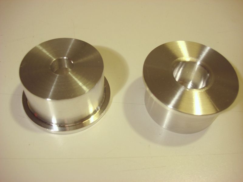

Gordo 0 Report post Posted April 28, 2013 Managed to get the rear diff mounts machined today. Share this post Link to post Share on other sites

Demesio 0 Report post Posted April 28, 2013 you're staying with the three diff mounts? why not be four mounts like the supra? Share this post Link to post Share on other sites
Kyle 0 Report post Posted April 28, 2013 I spy kingsford. Why not real hardwood charcoal? Share this post Link to post Share on other sites
Gordo 0 Report post Posted April 28, 2013 Demesio, A lot of work for 1 extra bolt. The car that Gaijin Smash has (my old X8) has the Supra diff in, and it took a bunch of work to get the pinion angle correct. The subframe has to be caved in to get the nose of the housing to sit high enough. And I was planning on completely changing that by making a new box section at the rear so that I could use the Supra rear cover, and use all 6 bolts. But that car was getting a 30 pounds of boost. I don't think my 7MGE will make enough to harm anything on this one. Kyle, Kingsford is the best for barbequing stray dogs. I also use paint thinner to light the stuff, it's cheaper than the faggity stuff in a bottle you buy in the grill section of HEB. Share this post Link to post Share on other sites

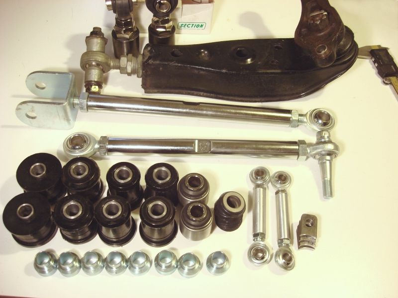

Gordo 0 Report post Posted May 8, 2013 Gathering pieces for the suspension that I have had stashed around the house for years into one pile. I am just waiting for the steel tube for the rear lower control arm, and a few rod end boots. The section universal arm adjusters will be welded to 1.5" DOM, with a 'fork' ends from a spare set of stock lateral rods will be welded to the outer end. Not sure if I am going to use the JIC tension rod, as I am having a hard time understanding why I would need an adjustable one that weighs twice as much. (chime in if you know something I am missing on this) Don't know if any of you remember, but the Supra spherical bushing that I am using, also fits where the tension rod attaches to the carrier. So I may jump on the net, and order another pair of those. Share this post Link to post Share on other sites

Gordo 0 Report post Posted May 20, 2013 Finished arms yesterday. Painted them a bright pastel fag color (just kidding) Now to work on the front lower arms. They already have the adjustable end mod, but have no reinforcement of any kind. By the way, anyone have a set of stock tension rods ? Don't want to start buchering mine, as they are still on the car. Share this post Link to post Share on other sites
