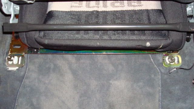

exciting sedan 0 Report post Posted February 18, 2011 RoyRogers - Try lining up the rear left with the outside hole and the rear right with the middle hole, just like what Mitch mentioned guaranteed it will work. I also used both the outer holes on one side to mount my Bride slider since they are a bit wider than the Sparco ones untill everything lined up. Universal fitment is a I used the Xcessive Seat brackets for the x8 in my Cressida this past week to install my Bride reclinable, the fitment is great! good quality seat brackets. Looking forward to getting other products from Xcessive. Drivers side, rear: Share this post Link to post Share on other sites
