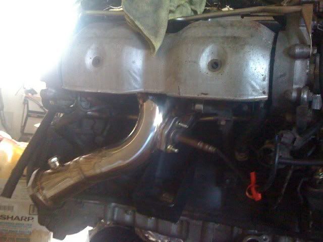

WhoreMouth_Jr 0 Report post Posted June 18, 2010 shitty ebay downpipe... already needed to modify... lame got oilpan on (hope it seals good) Drove all around town.. tried Napa checkers Redline. NOBODY HAD 7/8s heater hose for the twin's oil return line... Wack! Just need to finish grinding the motor mounts i bought which didnt line up... rubbed like 3 different places and even when i got it to sit flush the holes didnt line up.. sketchy stuff... so ya tomorrow finish the last mount! then start the bashing!! anyoe got tips on pounding the 1j + stock twins + r154 for an x7? Chick felt bad she couldnt really help past few days so she tried to paint me a picture haha (told her rims needed some dish =) ) shoots Share this post Link to post Share on other sites
JimmyHoffa 0 Report post Posted June 18, 2010 I wouldn't use heater hose for the oil return, go to a truck (like tractor trailer) supply place or heavy equipment place, they have 7/8 oil hose. The guy at the local place here almost always gives it to me for free because I only ever need a foot or less at a time and he can't be bothered to print a bill. Share this post Link to post Share on other sites
WhoreMouth_Jr 0 Report post Posted June 24, 2010 Ended up going with some sort of wet marine exhaust tubing for the oil dump. i went to hydra-air and took um like 30 minutes to find a 7/8ths hose that would be good enough to take hot oil. After a day's worth of bashing finnally got the motor mounts to line up!!! fuck yes! ha just missed a small spot on the passenger side in the well and then the trans mount should line up too! Only worry is how the intercooler is gonna get any air straped up behind the poor bumper. mocked it up today only an inch above and below the bumper are exposed once its mounted and such =( Share this post Link to post Share on other sites

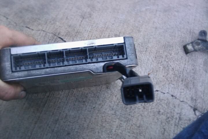

WhoreMouth_Jr 0 Report post Posted June 29, 2010 Finally trans found its home!!! Driveshaft In. Just needs Fluid, Piping, and wirng =) Just wondering really ... is itbad if there is a gap on each side of my radiator threw the normal hole? kinda hard to explain. But since i got a 2 row jzx90 rad. its a not as wide (left tor right) but its a little taller. Im thinking of using thin metal and covering the sides doubleing as Channel for air and extra mounting support oh snap also whats this extra plug for? im unable to find a pin out for it and the previous guy has a few wires to it Share this post Link to post Share on other sites
