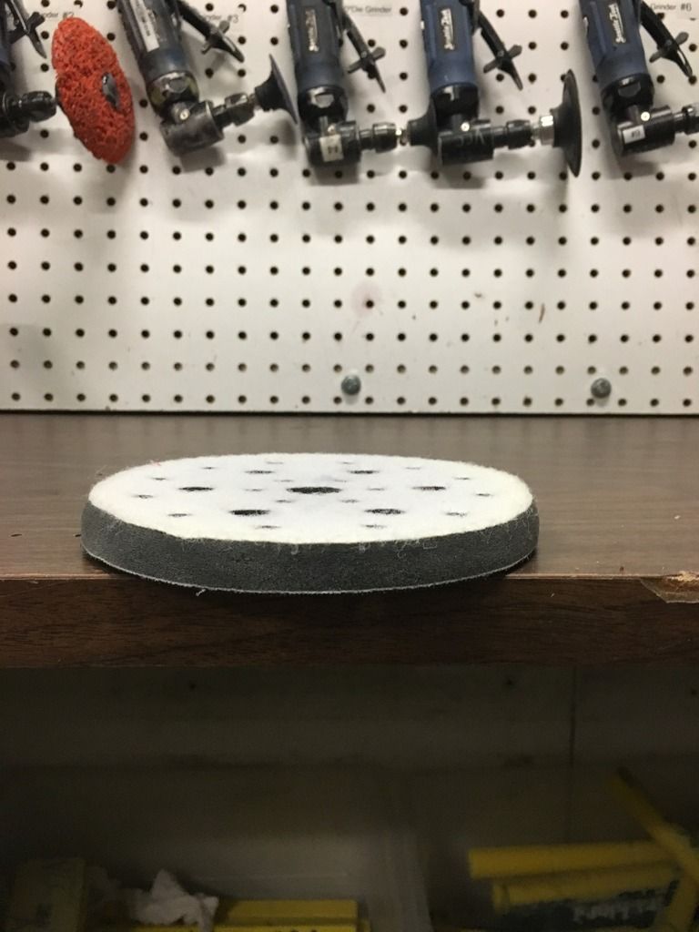

battleaxe 0 Report post Posted November 29, 2018 If u don't have a da sander, get one. Buzz the car down with 240/320. Block out any filler, sealer the whole car, then let that flash off, then shoot your colour. Make body work easier and quicker...as I imagine this will still be a skid car Share this post Link to post Share on other sites
LUMBERZACK 0 Report post Posted November 29, 2018 don't tell him to get a DA sander and not tell him about intermediate pads lol. You're going to make the man end up with an x8 that is as square as an x7. Share this post Link to post Share on other sites
battleaxe 0 Report post Posted November 30, 2018 What're those? I just know of soft and hard pads for the day. Each has their purpose. What're you talking aboot? Share this post Link to post Share on other sites
LUMBERZACK 0 Report post Posted November 30, 2018 3M calls them interface pads, but yeah they're the soft and hard hook-it pads you use between the DA and the paper. It may seem self explanatory for someone who has used a DA, but this is imperative info that's commonly left out. Share this post Link to post Share on other sites
battleaxe 0 Report post Posted November 30, 2018 aii lad. id suggest getting both kinds, for all kinds of work. Share this post Link to post Share on other sites

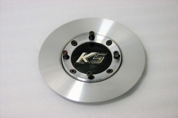

Tbone 0 Report post Posted December 7, 2018 Looking proper man!!!!! Fitment is fucking perfect !!! Looks like a game of millimeters.Fucking perfection is achieved with thoses ssr koenigs.One of my top 3 favourite wheel designs. Good luck finding center caps lol i see them come up on yjp here and there and holy fucking shit are they expensive!!! As far as the transition pads go yes they are cool.Mainly for scuff sanding contoured surfaces/back sanding/finish sanding primer surfacer ect. I have only ever seen the soft pad ones.I have never seen a hard pad transition pad or interface pad as you call them. A plain old hard pad will always be best for feather edging imo and a regular old soft pad work fine for finishing sanding and back sanding repairs before primer. Carry on... *Edit...Found one center capon yjp https://page.auctions.yahoo.co.jp/jp/auction/s624204642 Roughly $100usd Buy this one center cap and then you can take it to a machine shop/fabrication shop and say make me three of these please $$$$ Share this post Link to post Share on other sites
Gordo 0 Report post Posted December 7, 2018 Hm........ That outer ring looks a lot like the Volk Group-C outer rings. Does the inner cap have the threads, and holds the outer ring in place? Share this post Link to post Share on other sites

AcidTrip 0 Report post Posted December 10, 2018 @Tbone Thanks! Looks like ill have to try and put in a bid for it so i can have it replicated. @dreamweaverx8 ? What front bumper? i have a kit on order. I've waited a month already and it'll prob take another month. Share this post Link to post Share on other sites
Tbone 0 Report post Posted December 14, 2018 If you lose that auction try these.There's two center caps all listed separately 10 hrs left !!! https://page.auctions.yahoo.co.jp/jp/auction/e314559174 https://page.auctions.yahoo.co.jp/jp/auction/d321905651 Share this post Link to post Share on other sites
WhoreMouth_Jr 0 Report post Posted December 14, 2018 Jesus 150 per center? Ouch Share this post Link to post Share on other sites
AcidTrip 0 Report post Posted December 14, 2018 @Tbone Those aren't the same. i think those are for a smaller face koenig? they only have 4 mounting holes. Mine have 5 holes that mount the cap to the face. but i did buy the original one you posted. it was around 150 after shipping and fee's. i plan on having someone machine me a new set of 4 and ill buy gel centers from someone. I found a guy who said he could machine 4 perfect replicas for 200-300$ i kinda want to have the gel centers to say KYS instead of KS. LOL Share this post Link to post Share on other sites
AcidTrip 0 Report post Posted December 14, 2018 @WhoreMouth_Jr 150 is dumb pricey for 1 cap but welcome to owning a rare set of 3 pc wheels. rip me. Share this post Link to post Share on other sites
