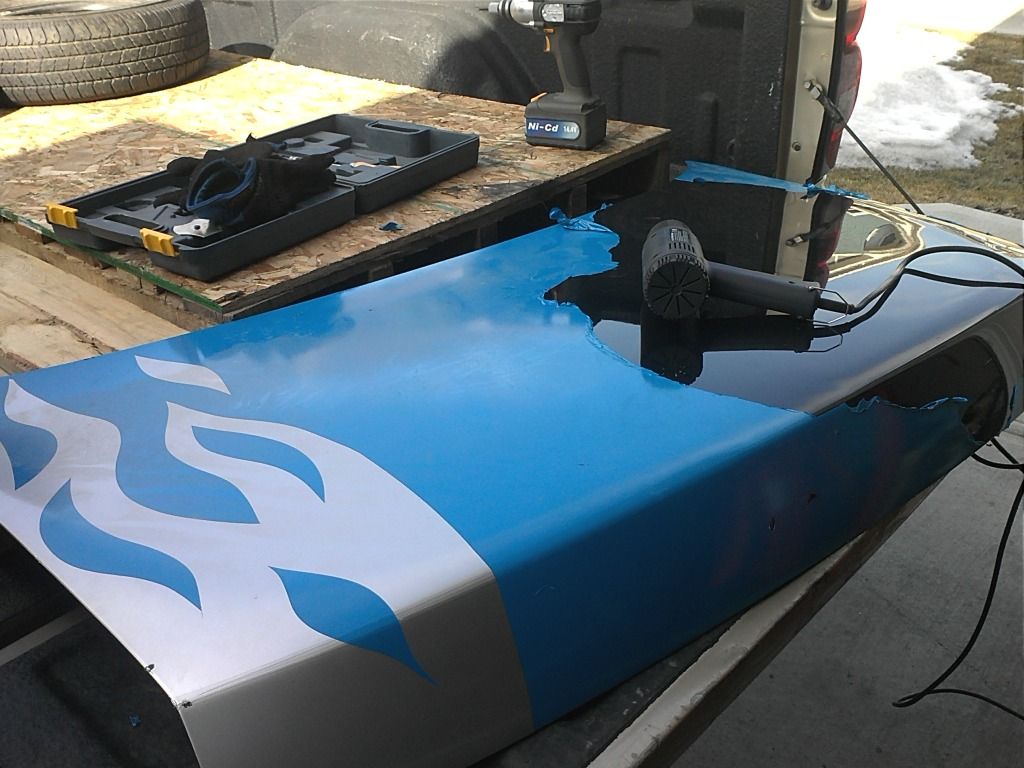

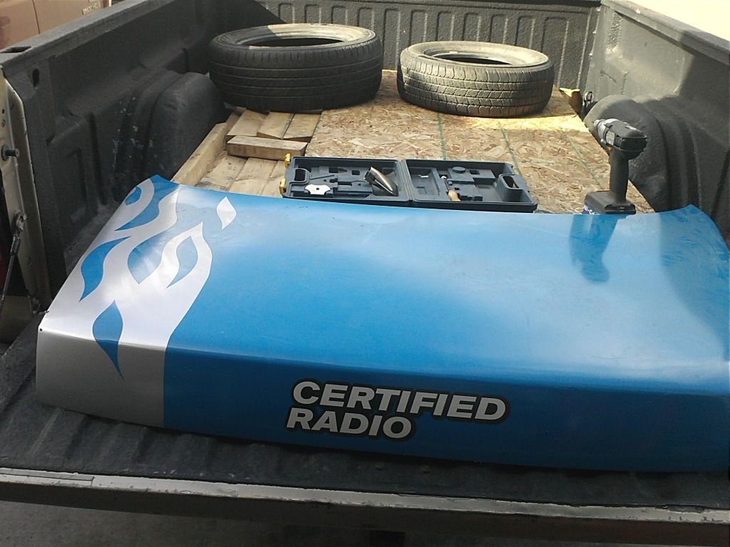

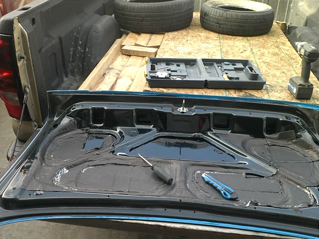

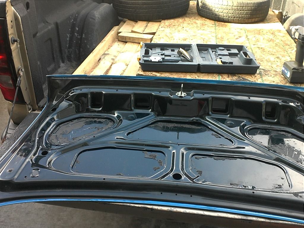

So my trunk lid off of this Chaser was fucked cus it had some lame wing on it and we ripped it off and yea, so had to grab the one from my blue Chaser as it was all good, but it had tons of aftermarket sound deadner from when my Chaser had a huge stereo. That needed to come out
Took about a half hour to an hour, and got a couple good cuts in my hands before I put gloves on haha
Next was to get rid of the blue vinyl
With the heat gun that came off alot easier than the deadner

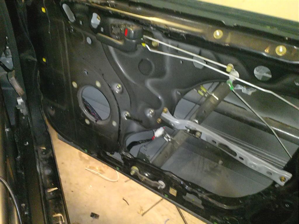

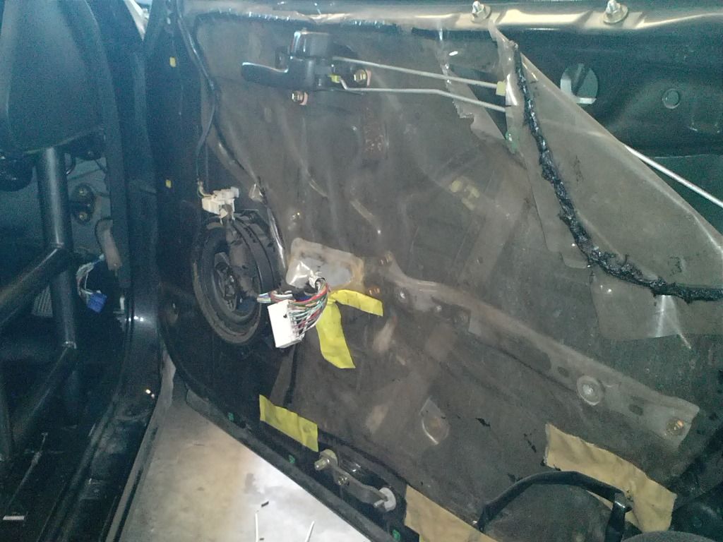

Back to car after guy, took the door panels off and started to remove stuff

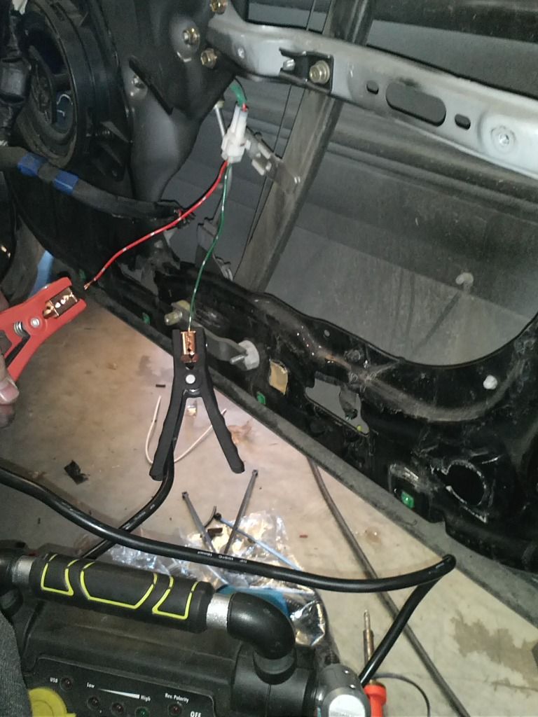

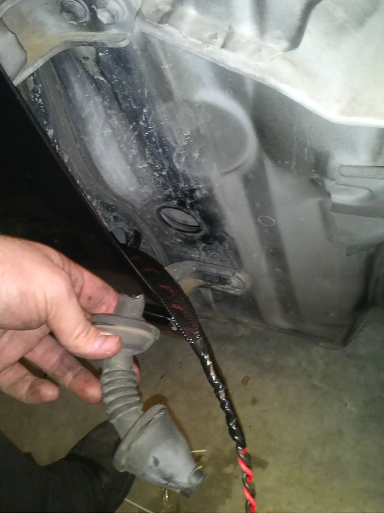

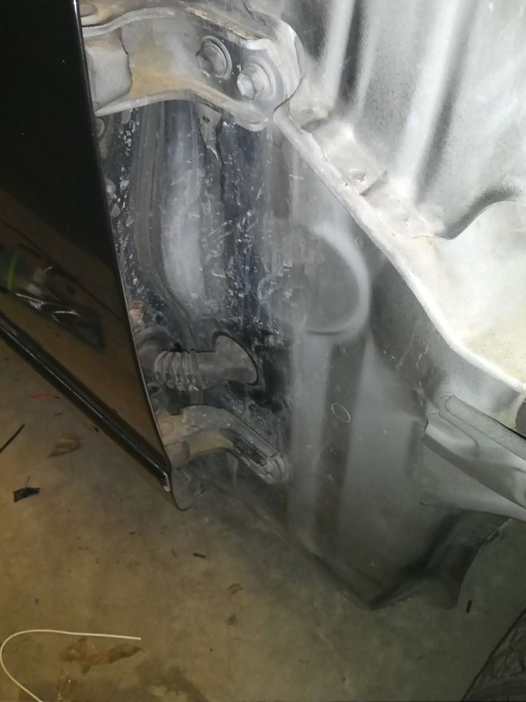

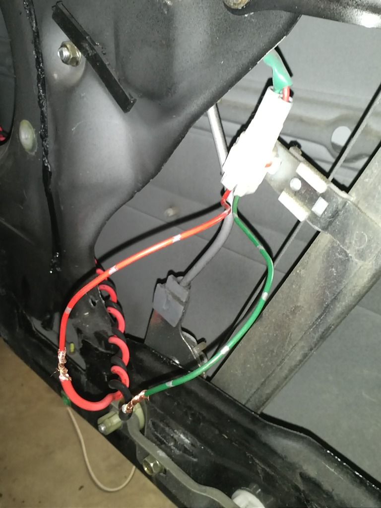

Had to roll the window up to get to all the wiring, so I hot wired the motor, also helped me figure out what is what for wires
Attached new lines so I can wire it into my painless set up, yes it is all soldered!
Loomed and ran through the factory boot
Way cleaner now!

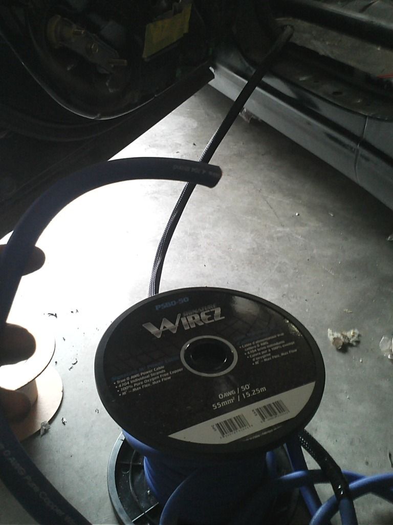

Just some of my gear they sent me, and all the Wirez wiring that I need to get the car going and rewired!

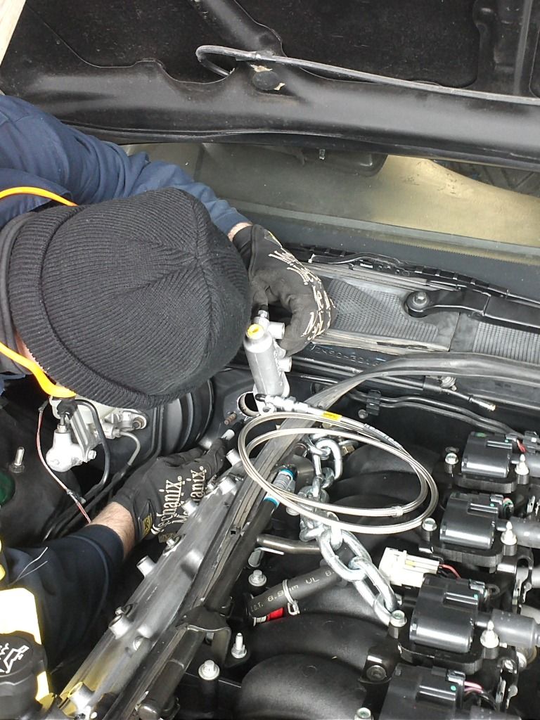

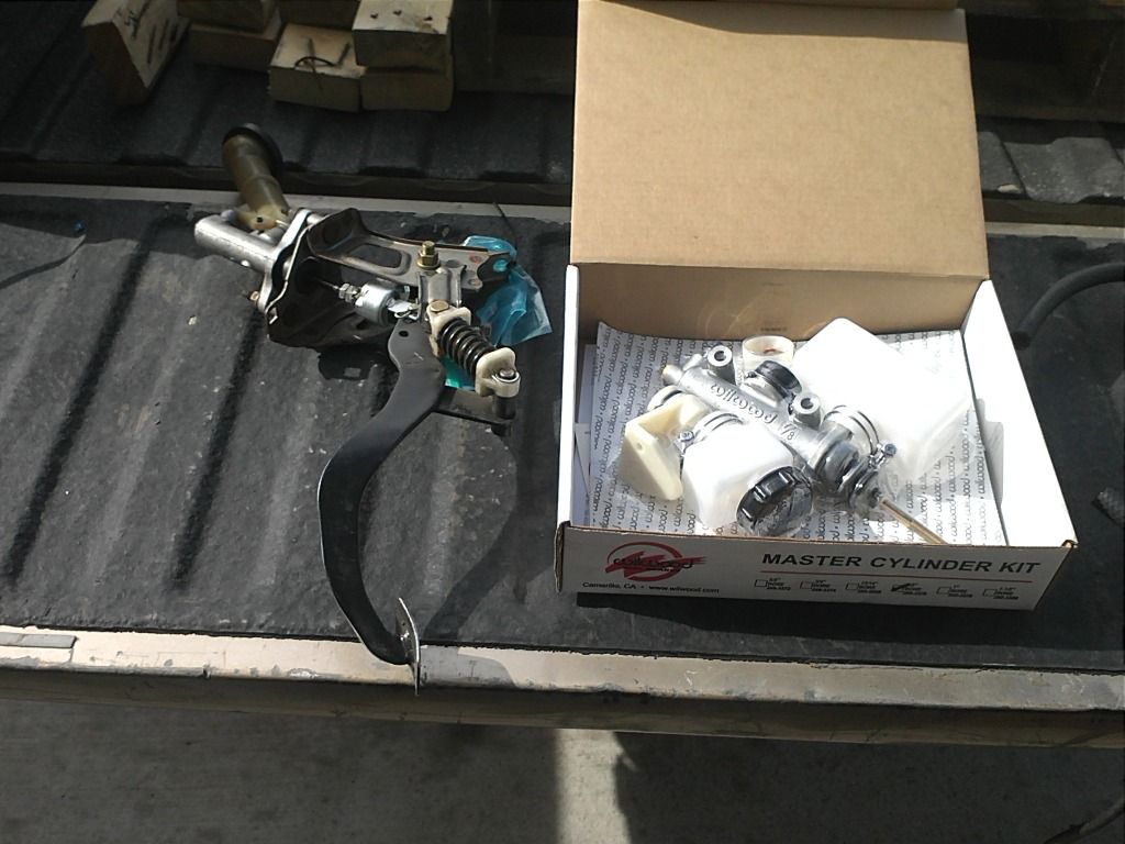

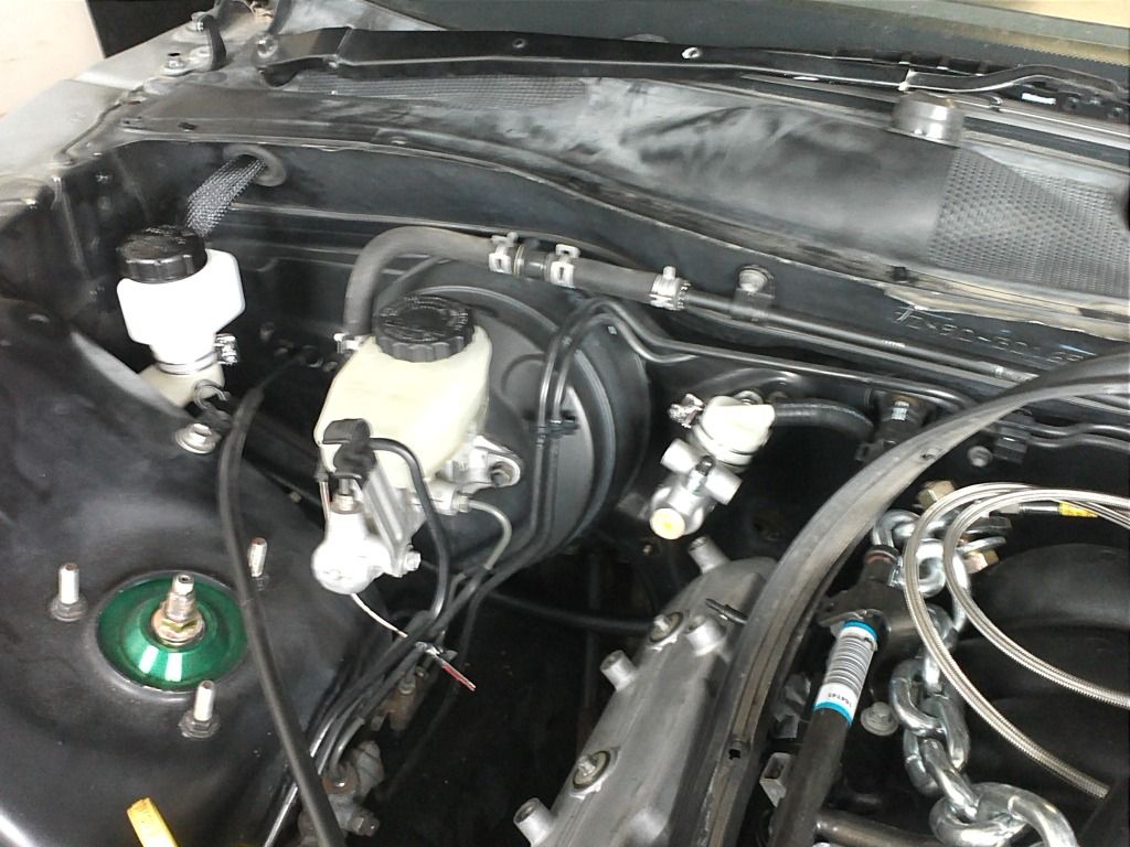

My friend came over to install my Wilwood Clutch Master with remote reservoir, had do modify where it bolts to the pedal and where everything hooks up. He has this same set up in his RX7 with a 660hp LS3.
Remote reservoir mounted on the strut tower
Pedals all installed, and swapped from the auto huge brake to the manual smaller brake

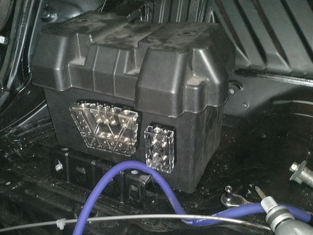

Started to run my main power wire with Wirez power cable
Battery box installed with my power distros, and also mounted my battery kill switch on the back of the car

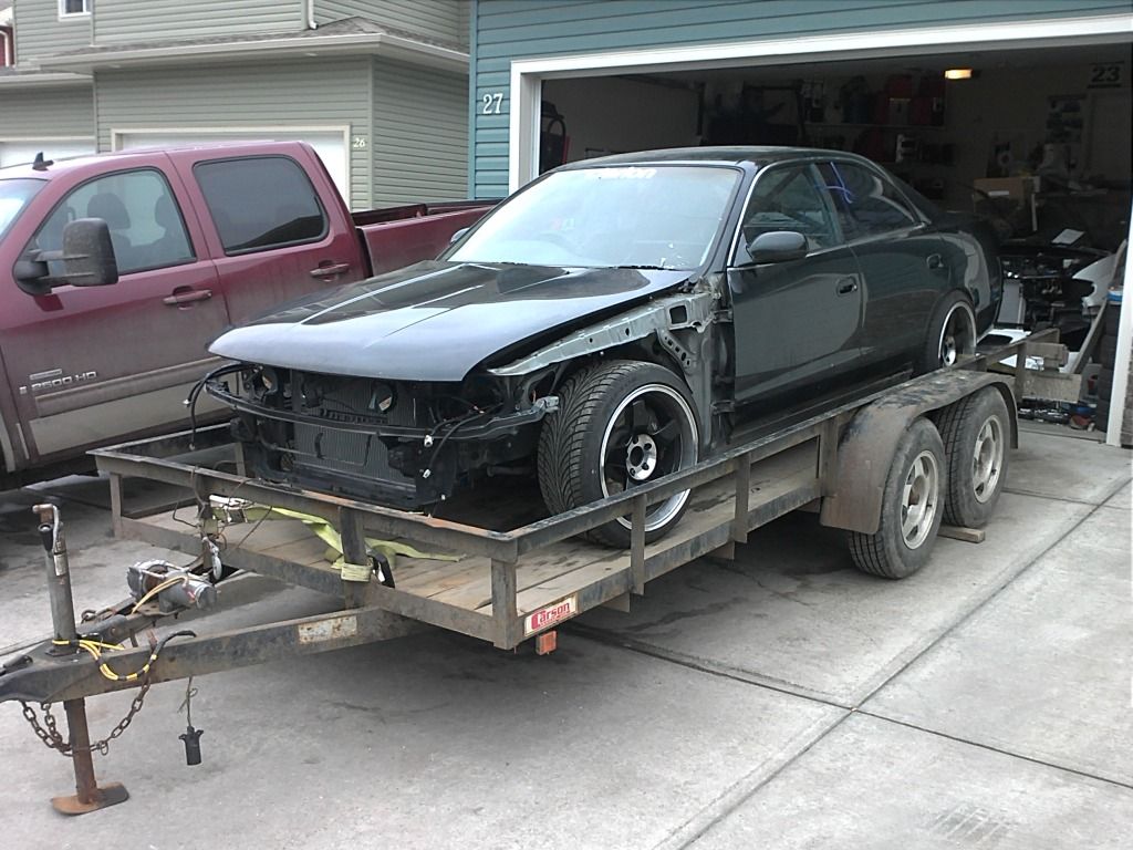

Loaded up onto the trailer and took for custom headers, dropped it off this morning!

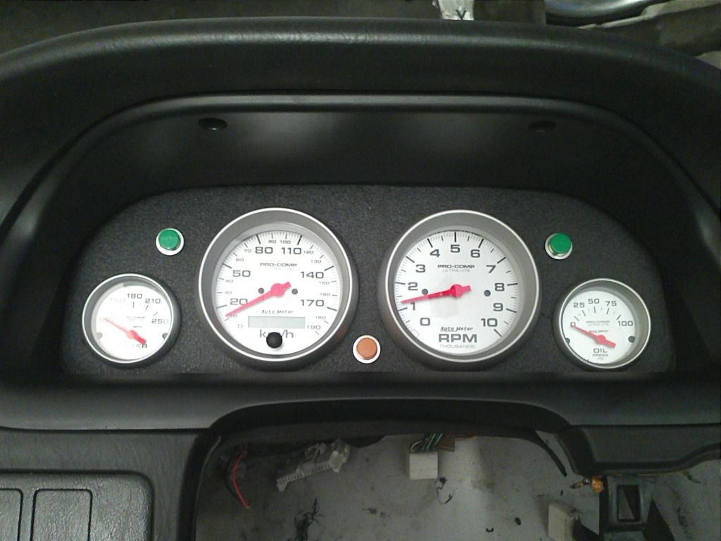

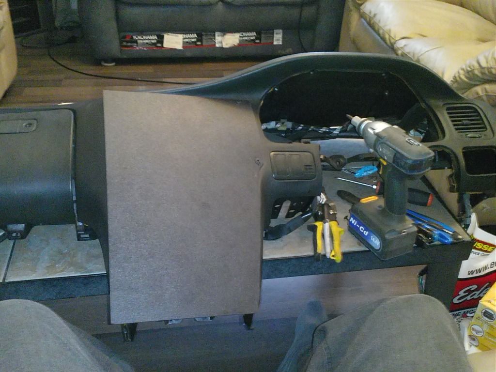

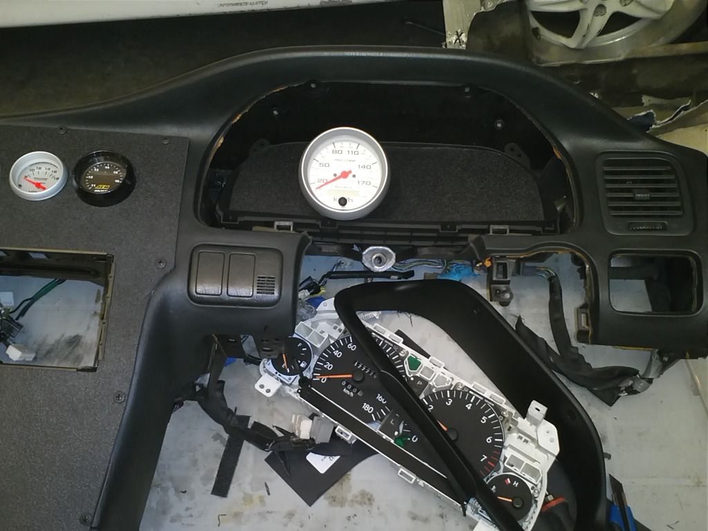

Started out working in my living room on the dash panel
Then moved to the garage to drill the gauge holes as I didn't wanna sweep up after getting stuff everywhere
Had to cut the hole for my double din Clarion head unit that is going in
Then mounted my switches, my gauges, and the double din cage, the deck I'm getting is not released yet so they haven't even shipped to North America yet so waiting on the deck to go in. Those are my switches for my heater/defrost, strobes, and other random things.
I was lucky enough that I had my spare dash at home that I could do this, as the one for my car is in my car at the header shop

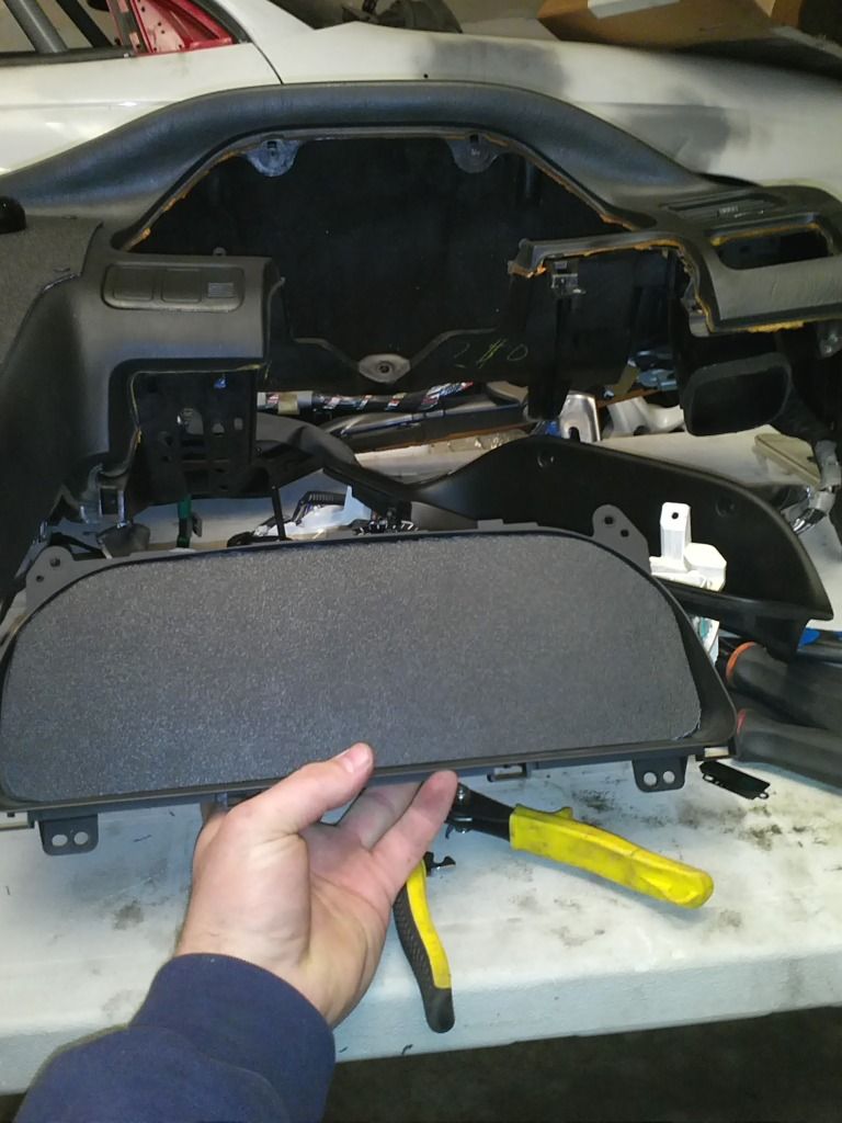

Started to make my gauge cluster, took the factory cluster apart, then made a sheet of abs plastic fit in.
Then I cut out the inner mount of the cluster and mounted the abs inside of it
Didn't take many more pics of the cluster install, but I had to modify the factory cluster and take parts off of it to mount it, but now it's mounted and looks great

The cluster looks good. Is your center light for check engine or highbeam indicator?

Thanks, the yellow is check engine, the place I bought my lights from didn't have any blue lights for high beam, so I tooka single bright blue LED and put it in the bottom of the cluster pointed up that I'm gonna use for it. Otherwise the led light would point right in my eye while driving haha

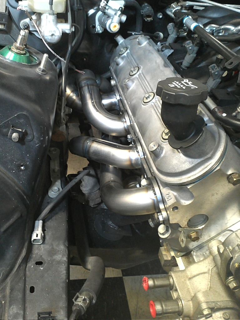

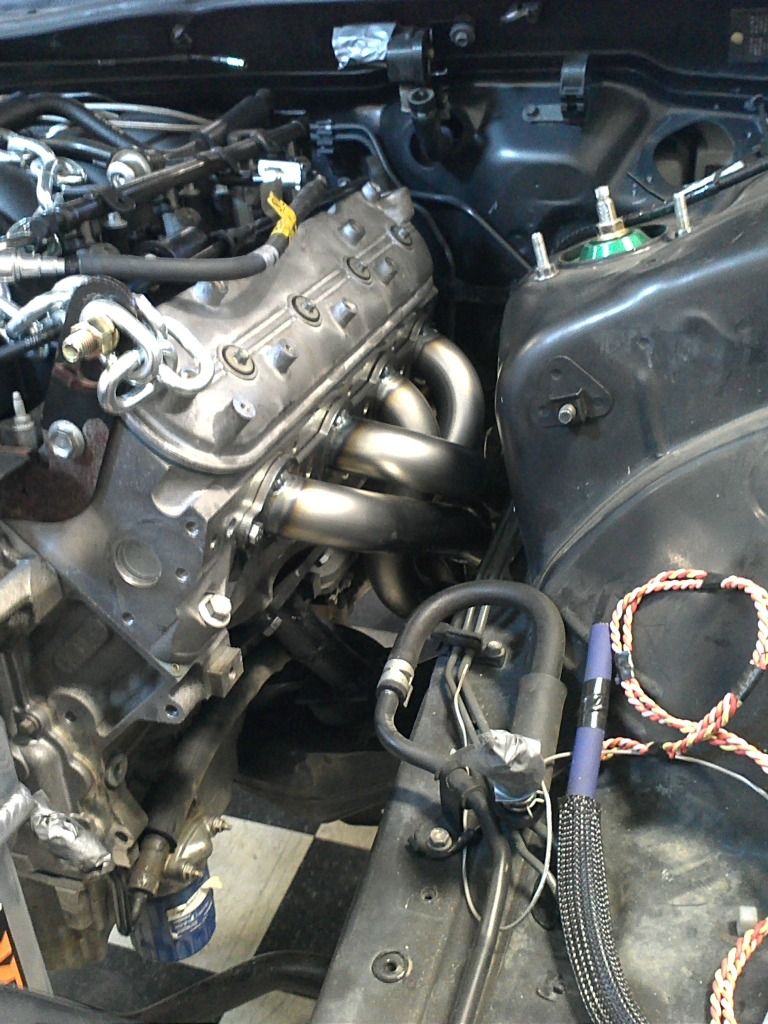

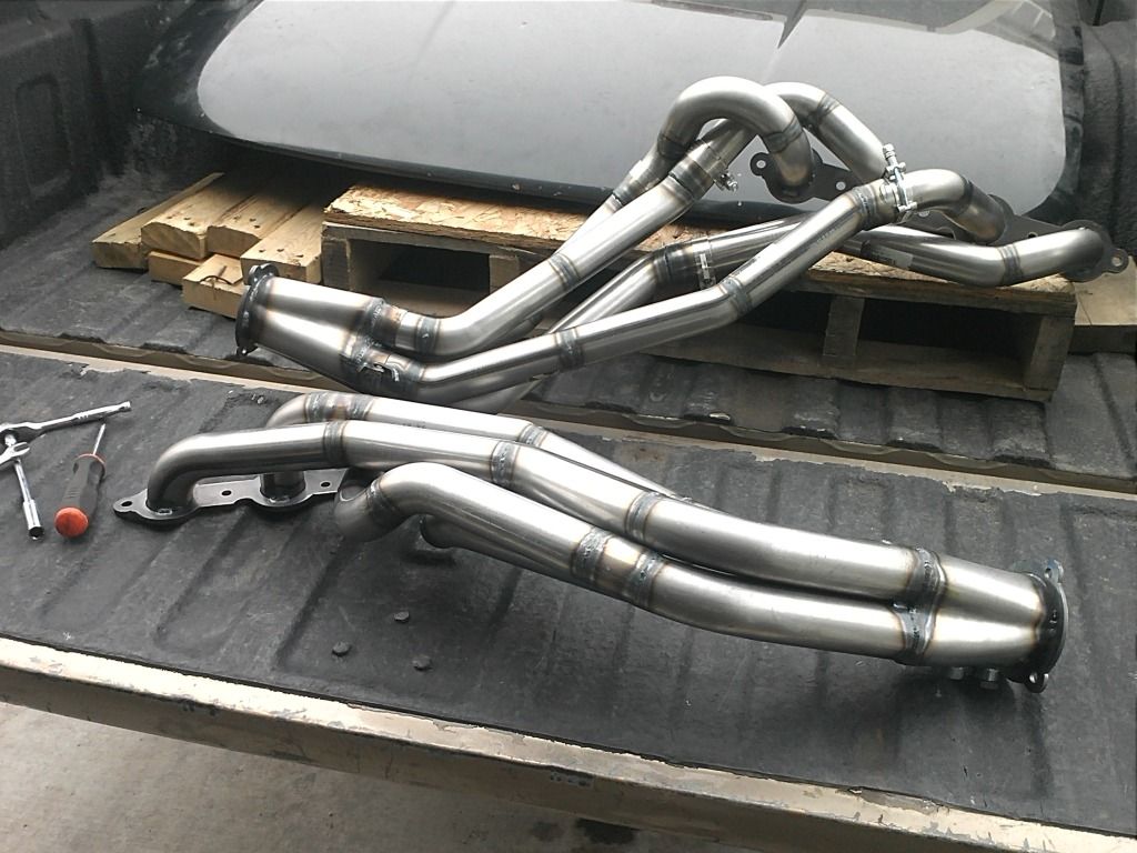

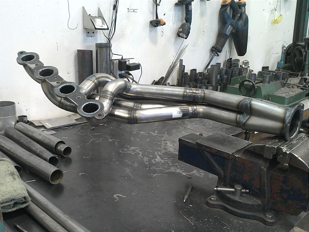

Well I know everyone is probably watching Formula D today! But I took a break from that and went off to NPP to see how my headers were coming, and they are almost done!!! just needed to finish up a couple welds and then put the clamps on my 6 part driver side headers. Pics below.
Passenger side in car
Passenger side out of car
Driver side with some of the lower pipes removed
Picking up tomorrow!!!

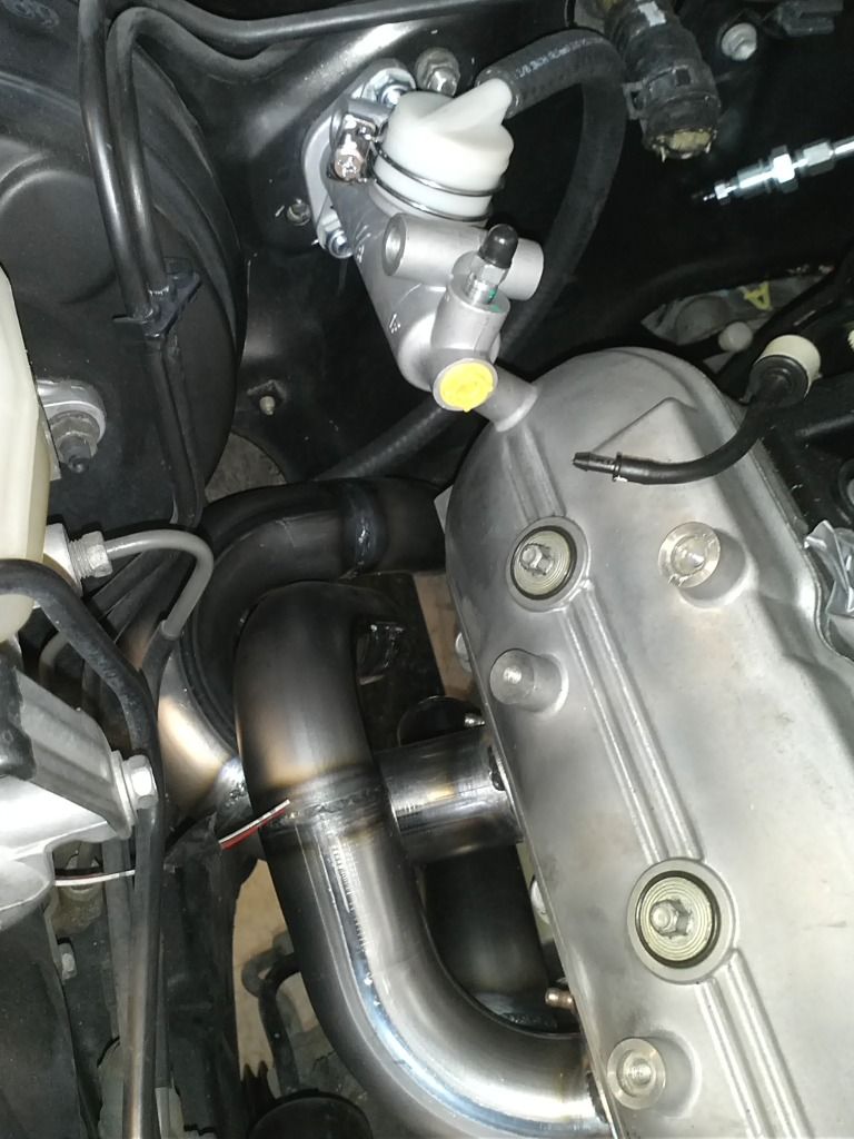

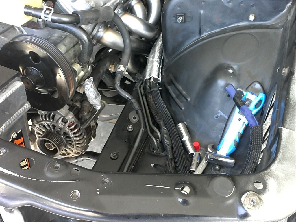

Well I got the power steering pump and alt back onto the car
View of the headers on from below
Ended up pulling them out so I can get the ceramic coated, damn it was sorta a puzzle on the 6 piece one after I took it out to go back together
Got my power kill switch mounted up
Wired up to my Wirez power distros
Also took the wiring out of my frame rail, just incase I have a minor accident that it doesn't crush the wires, so I heat wraped it and ran it through the engine bay

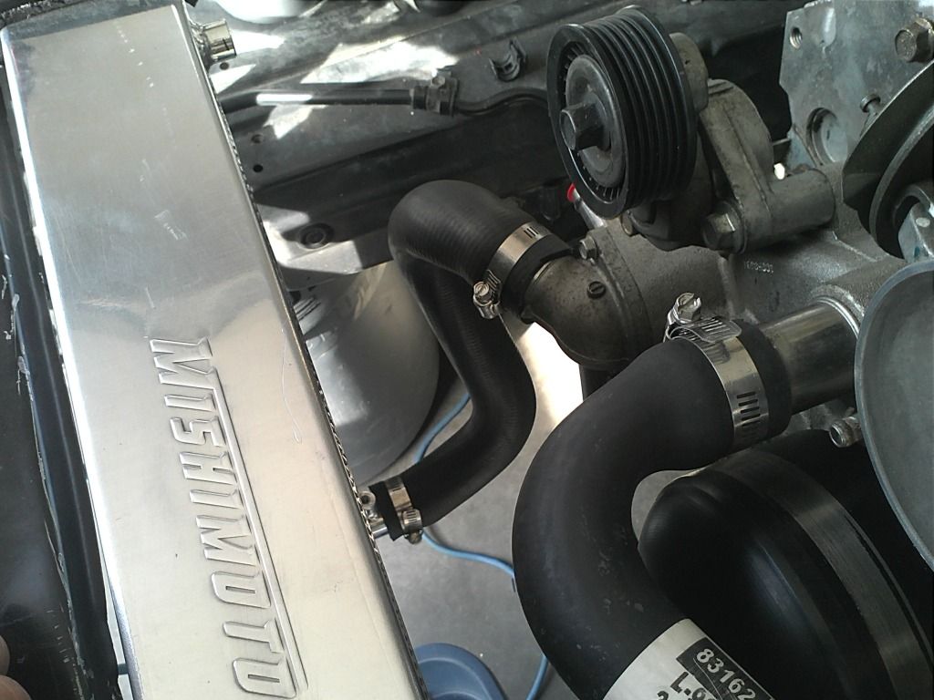

And got some radiator hoses
