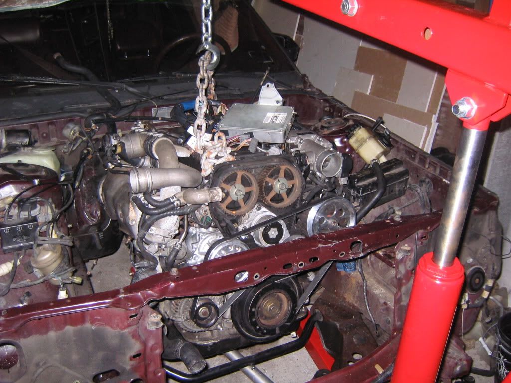

Since i dont have any post on this website i figured i should share my build.

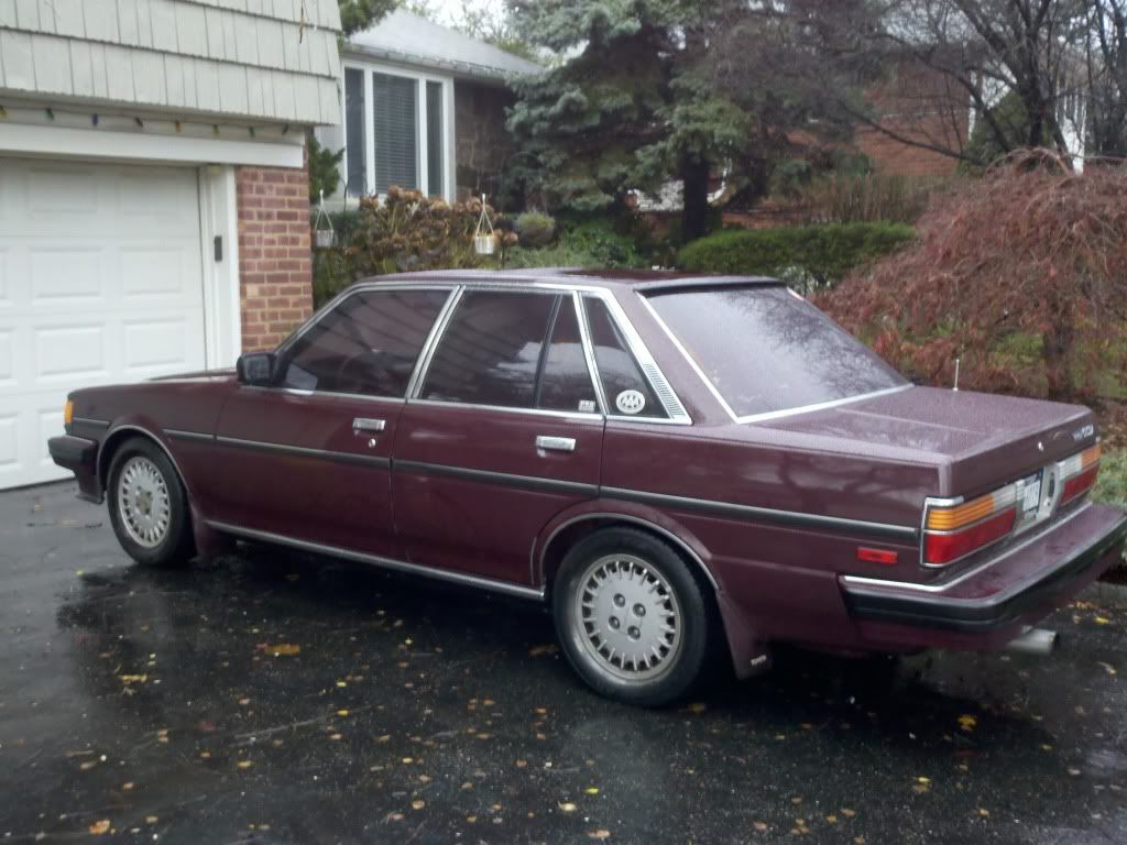

My X7 was my first car and upon realizing how fuckin pimp it is, a few years later i decided to do the logical thing > 1JZ

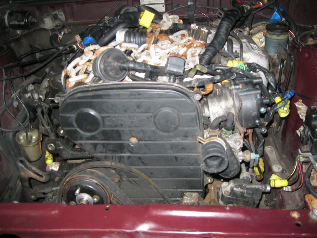

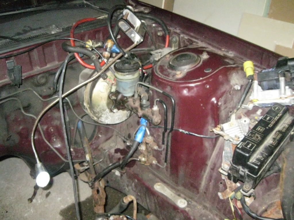

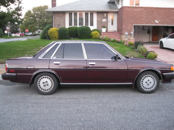

Heres what i started with

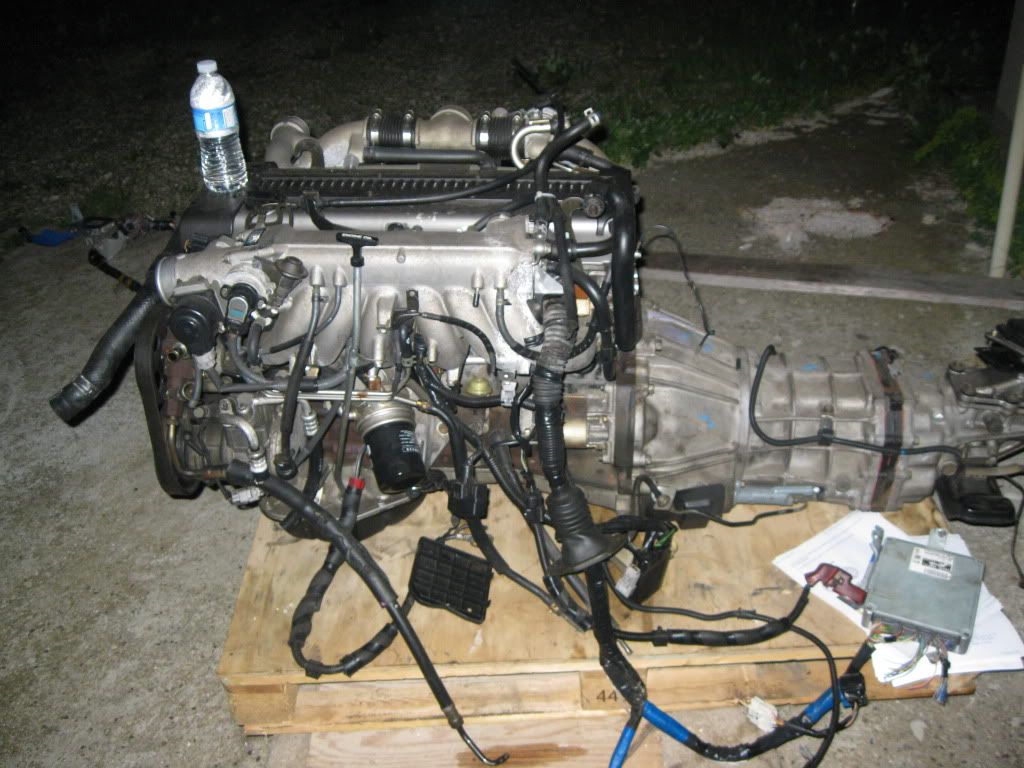

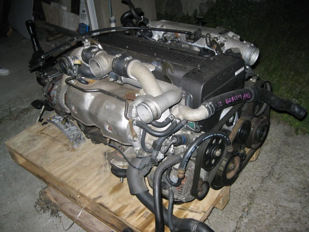

Then this happened first shots of the engine at home

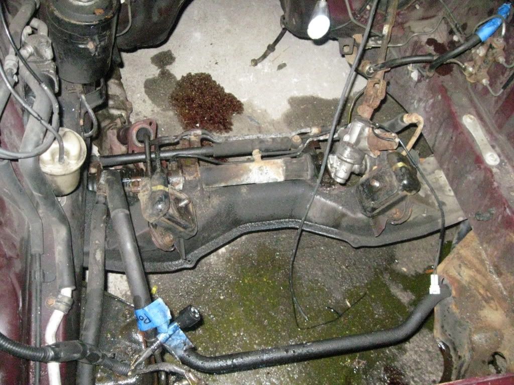

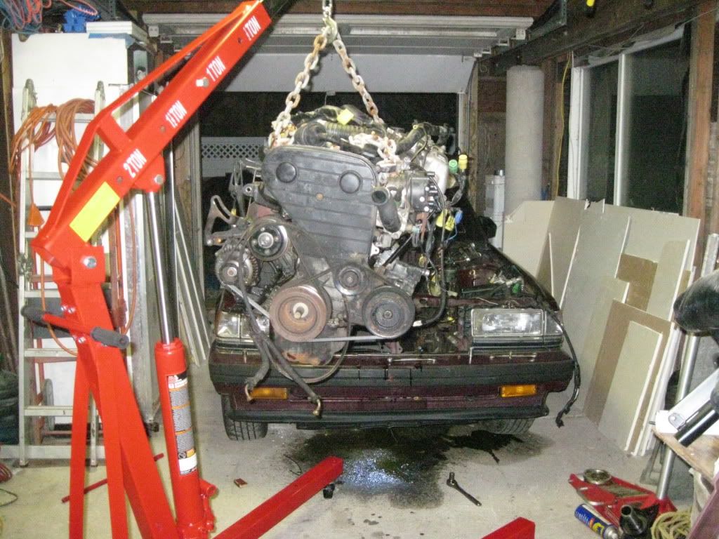

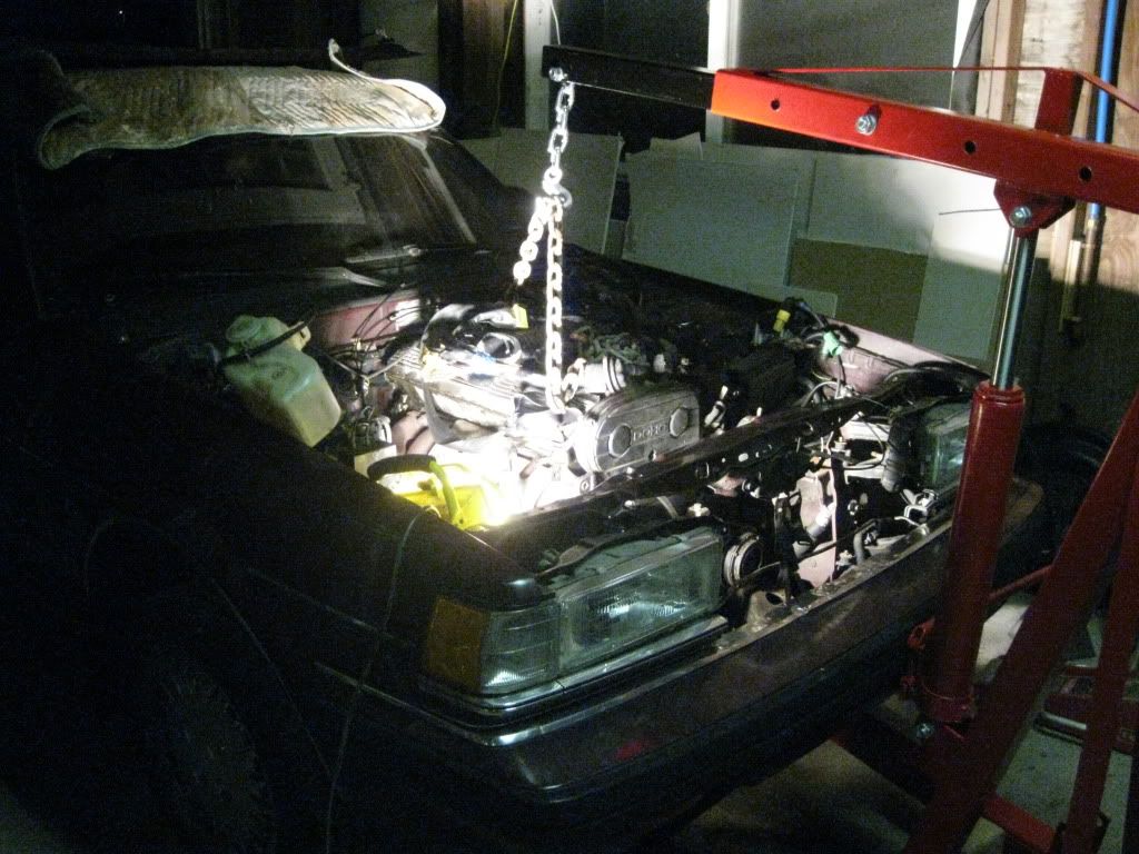

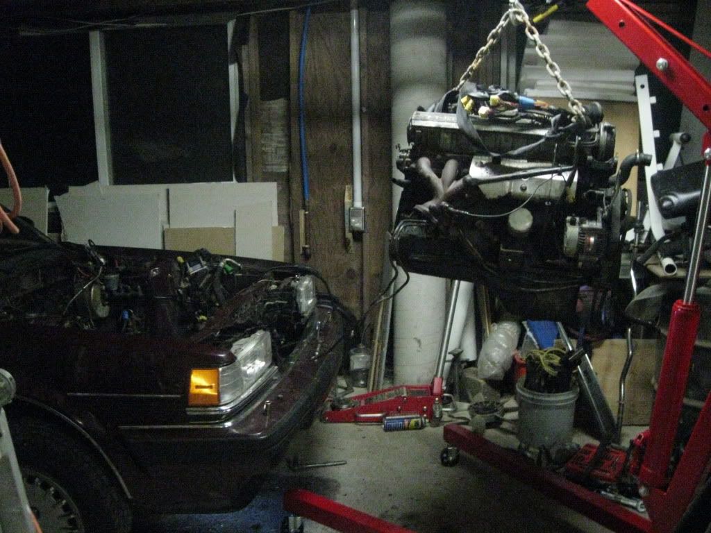

and now it was time to pull the old 5m ( That i had destroyed top and bottom end "trying" to drift )
Now that i had taken the trash out i had room to work!

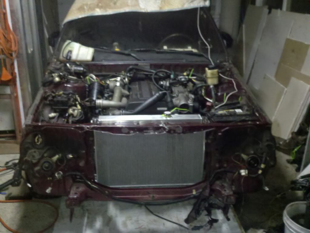

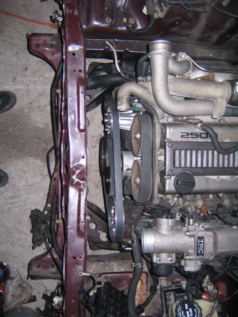

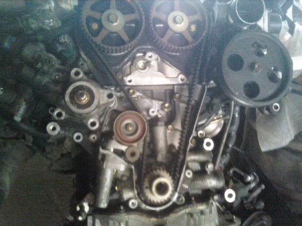

some maintenance timing belt serpentine. 2jz water pump etc...

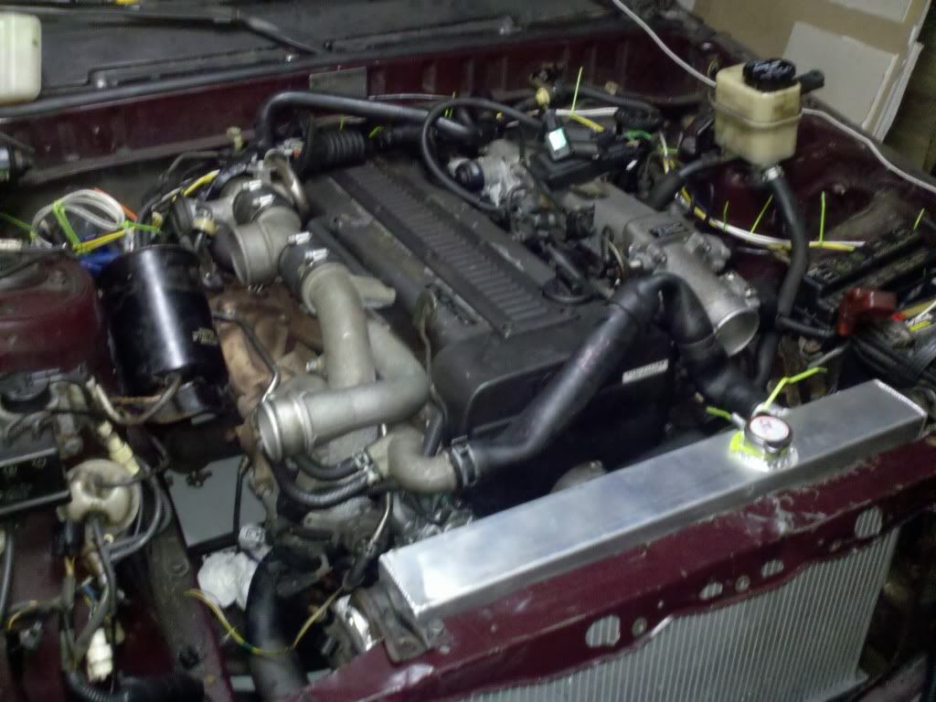

Next i had realized i had to make the engine fit... this is where the BFH technique came into play. Mounts came from celicasupra forums
After the bashing the Y&S technique was used to maneuver the engine and tranny to theyre final resting

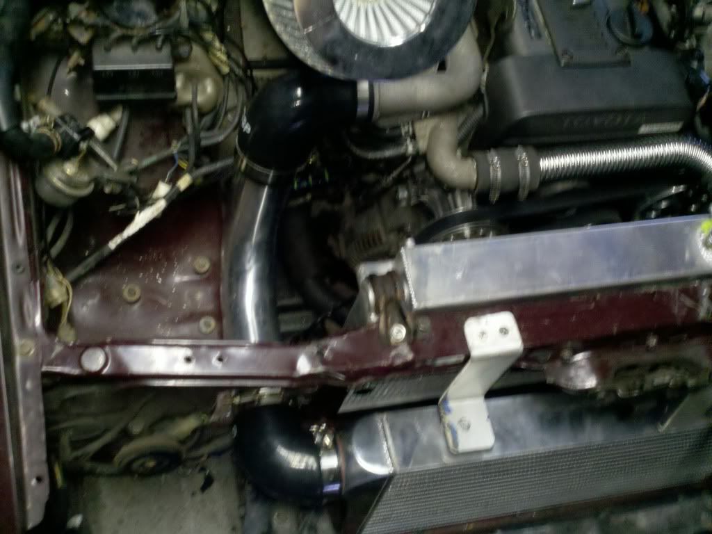

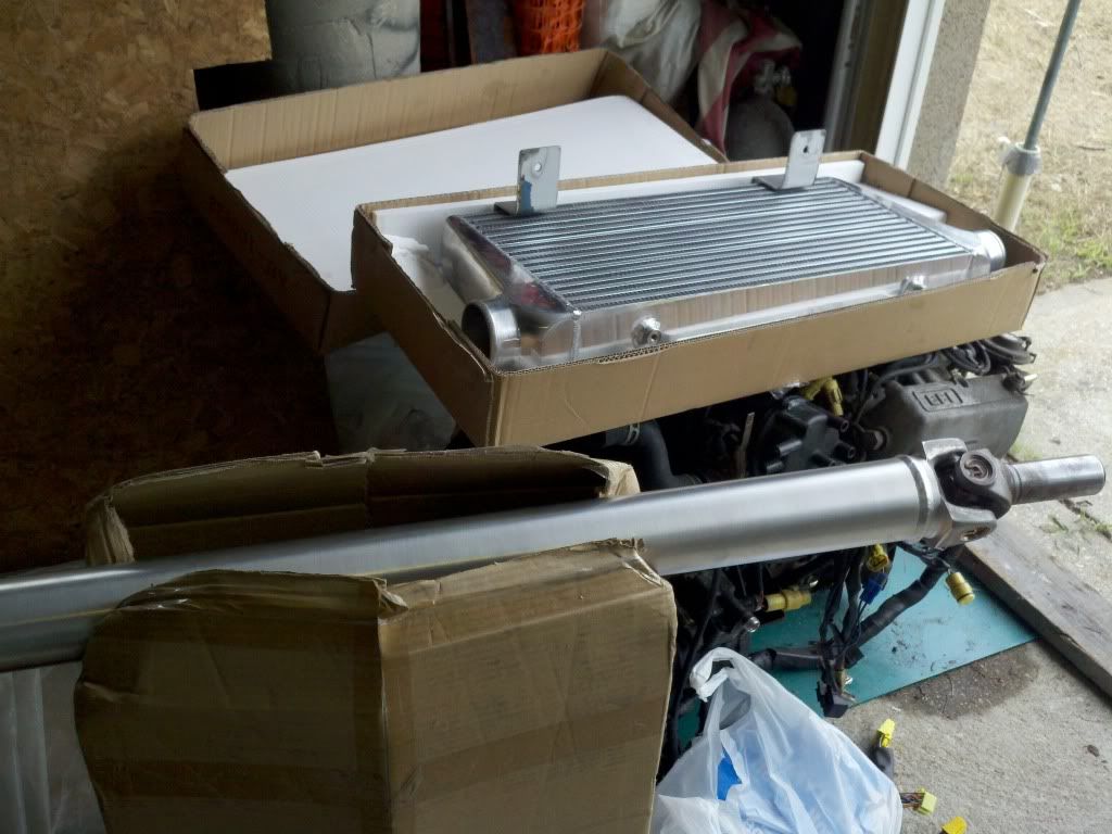

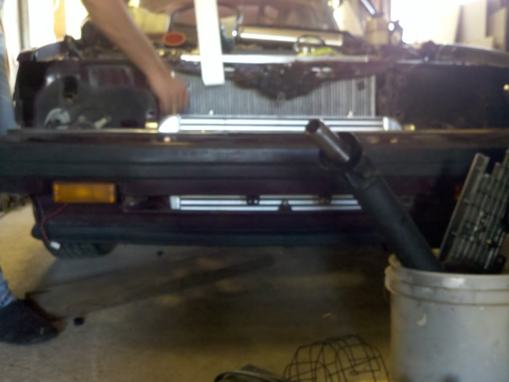

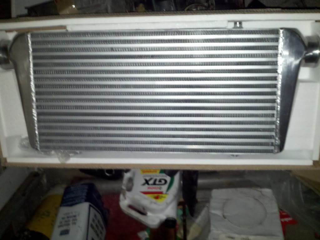

Next was to fit this bad boy ( got very lucky and ran only 2 pipes to meet the engine!
As for the driveshaft driftmotion made up this aluminum bad boy for me

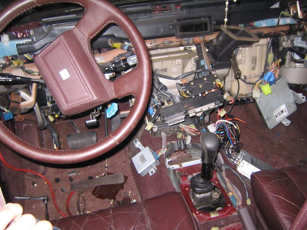

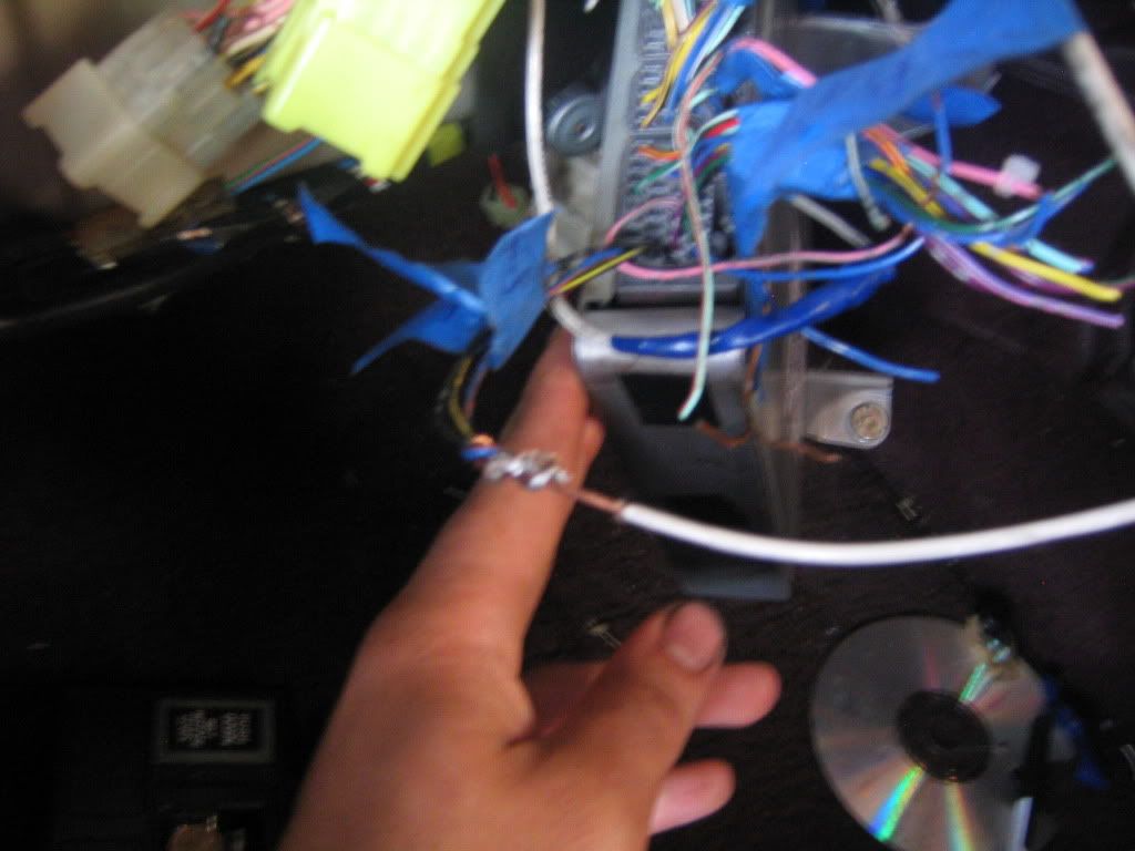

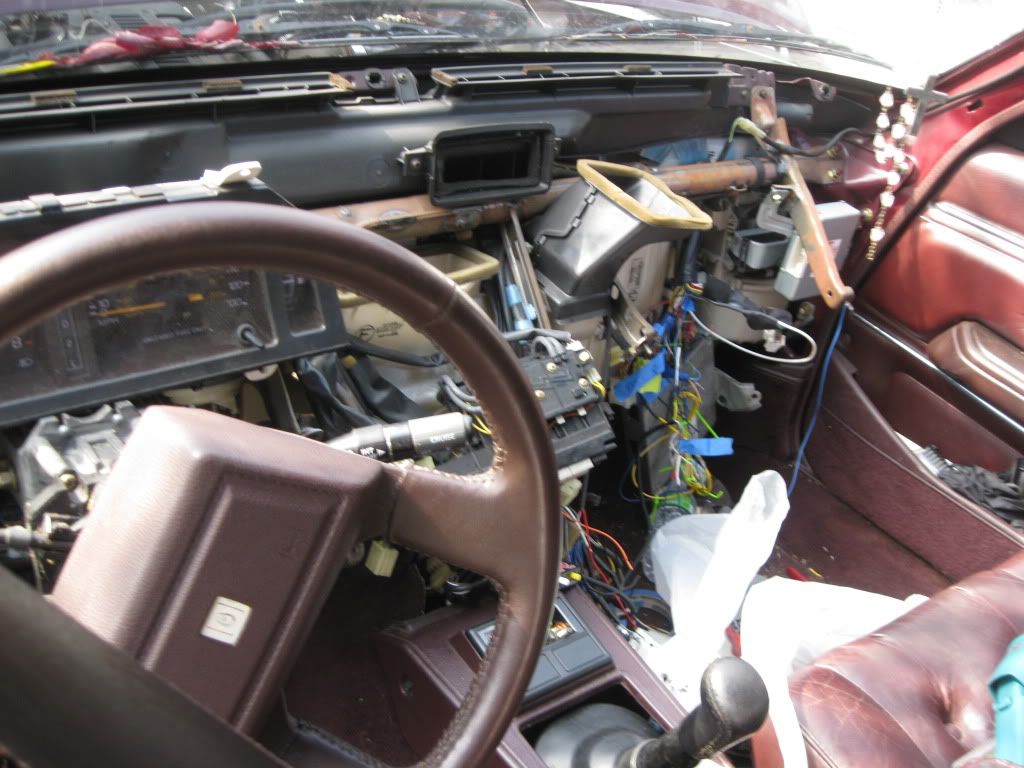

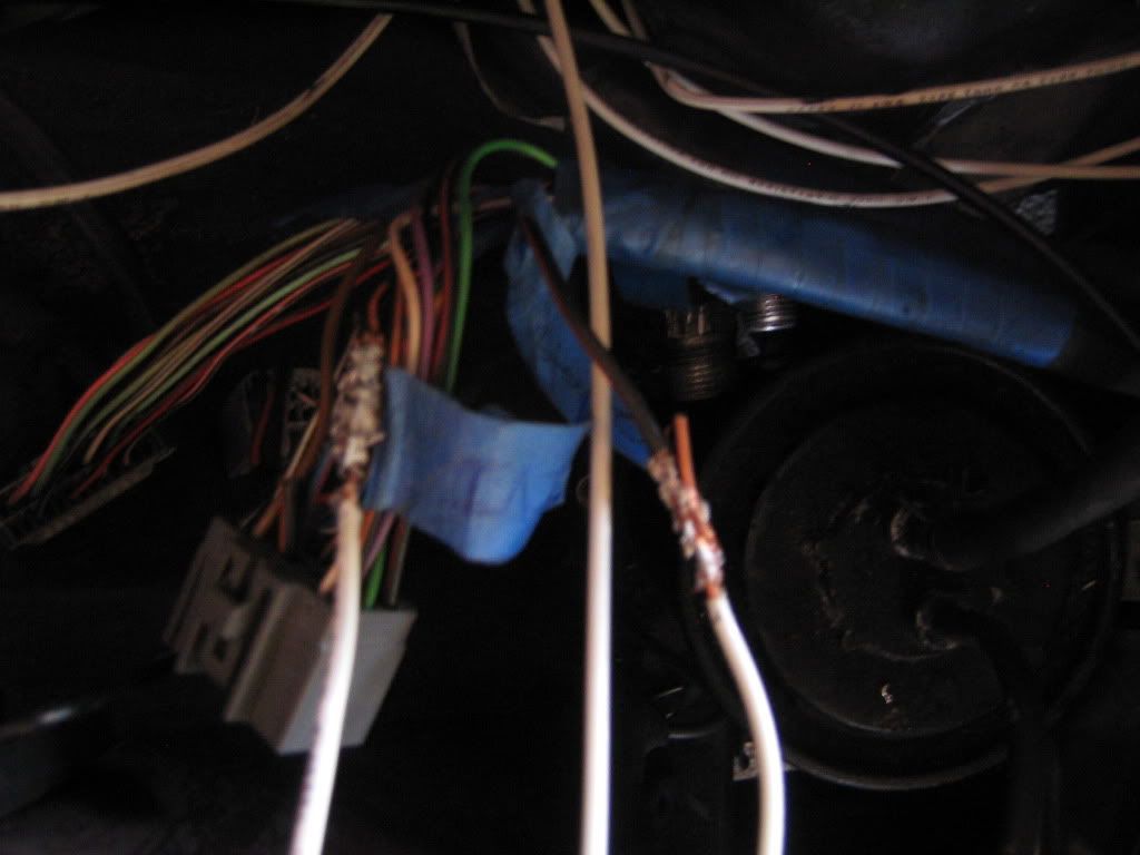

Then came the wiring.... after spending many hours in the car staring at a million fuckin wires i had managed to wire it up into the chaser harness. ( X7 dash makes a great beer bottle holder) I Also modded the tacho board with the according resistors.
With a few more modifications and alot of zip ties ow she was ready for a test drive :D

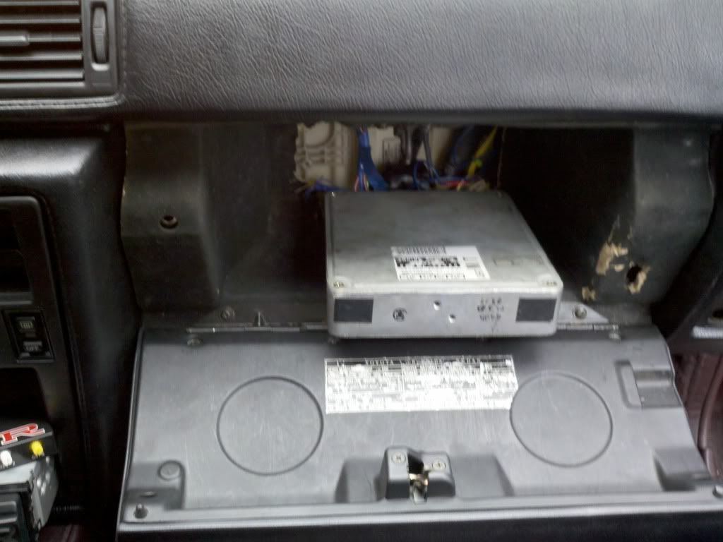

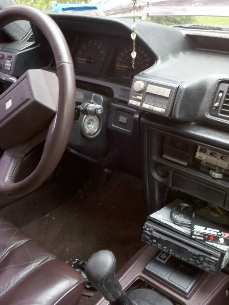

The glovebox is now home to the ecu

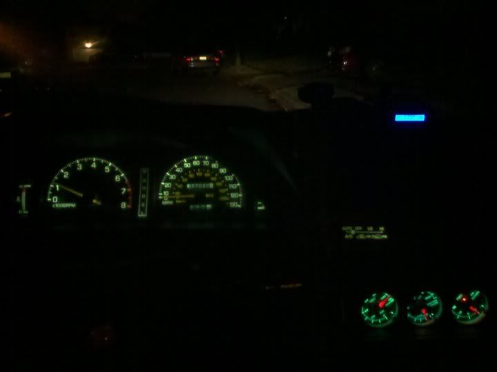

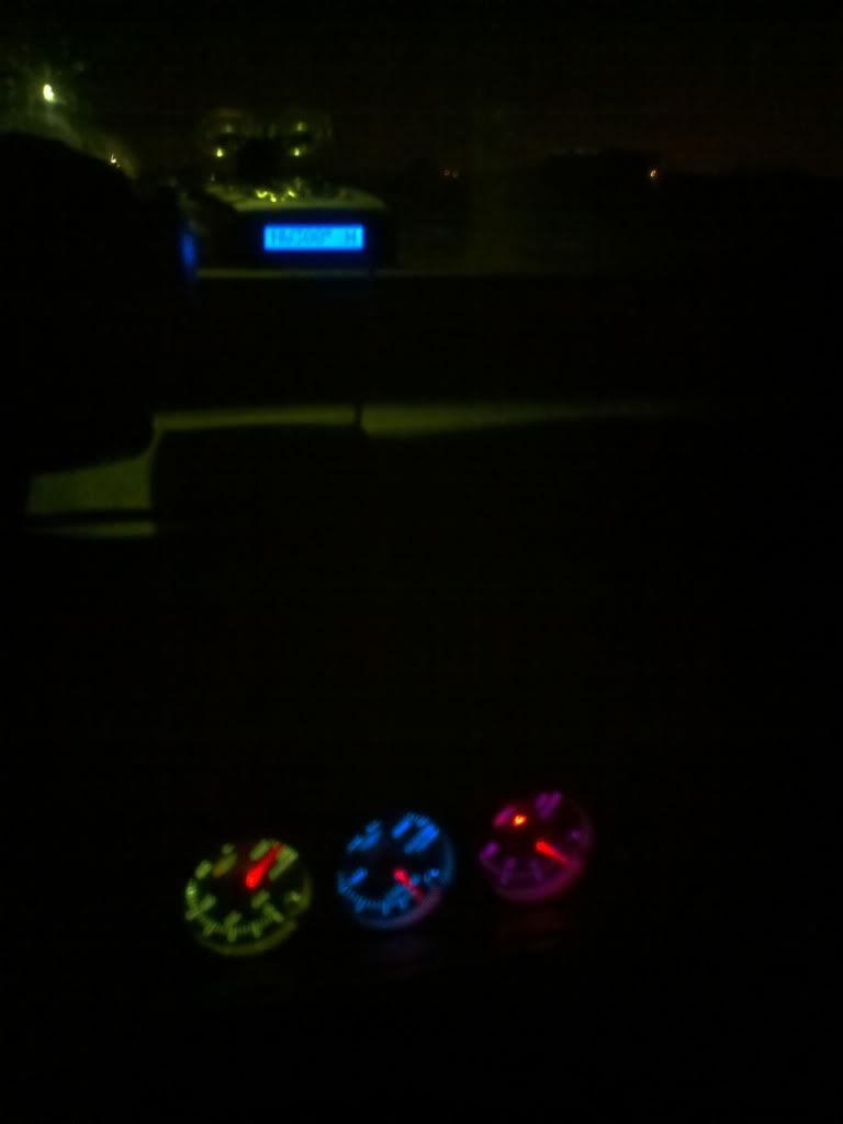

Here are my gauges mounted in the dash.. 7 color led

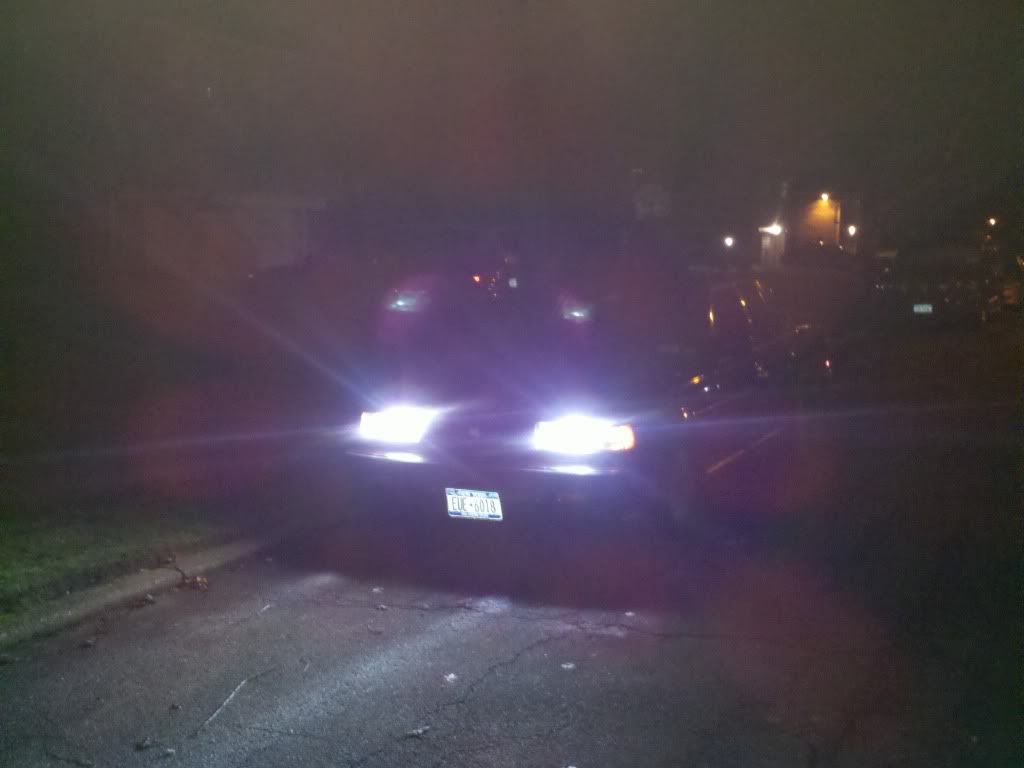

Got some HIDs 55w 5500K

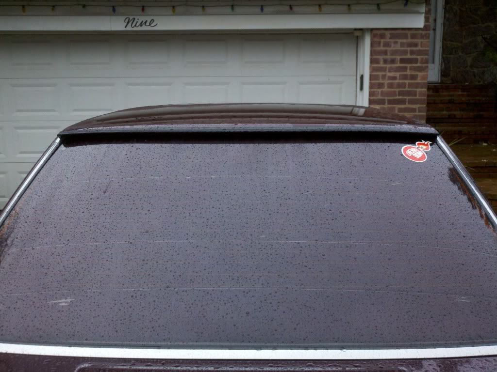

I put on this e46 m3 roof spoiler ( no i dont have a cherry bomb )

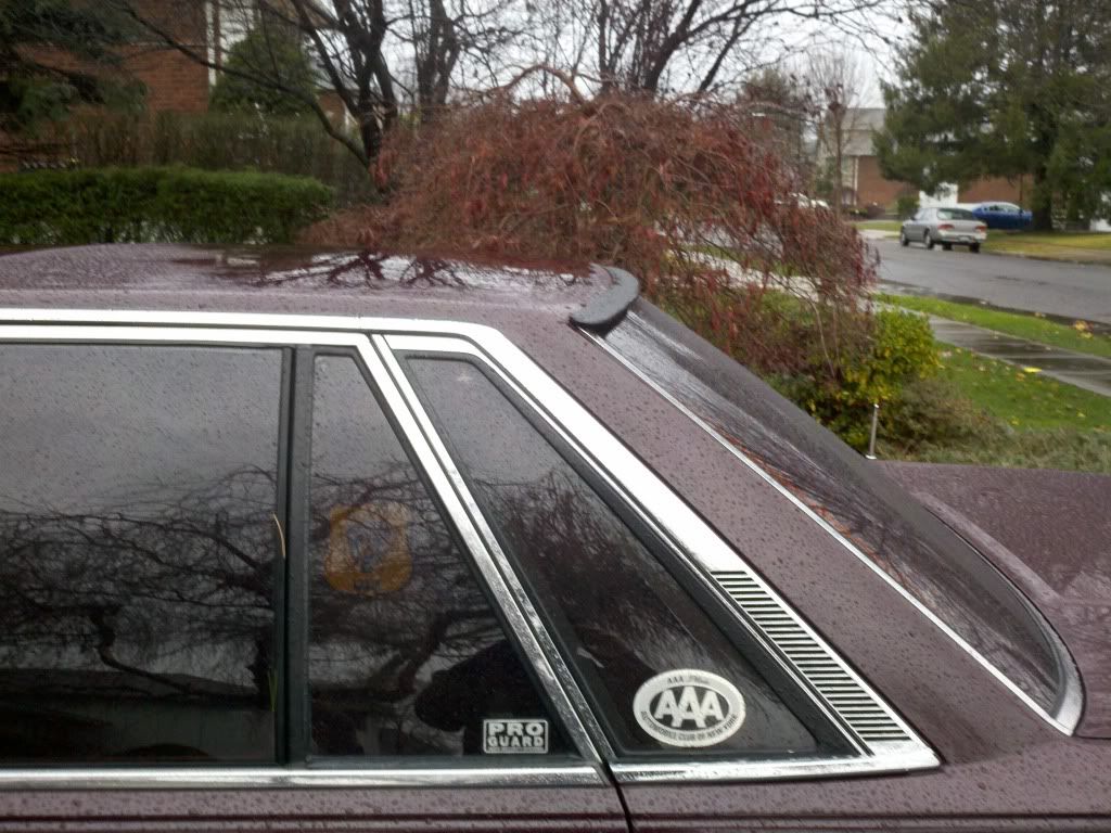

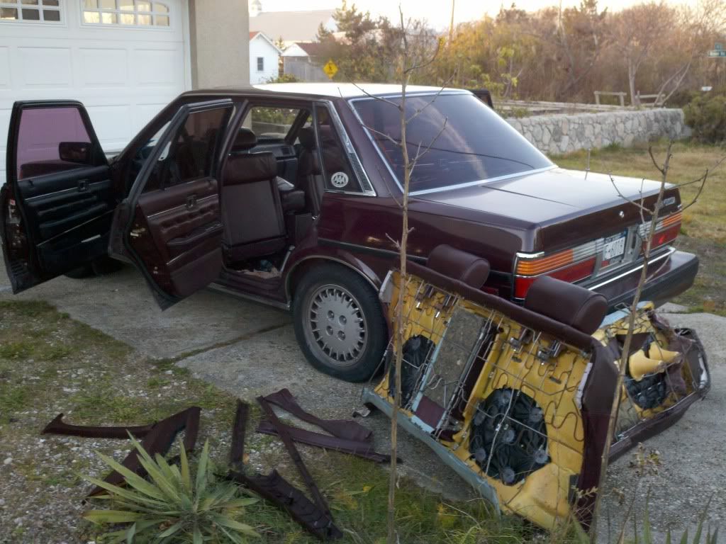

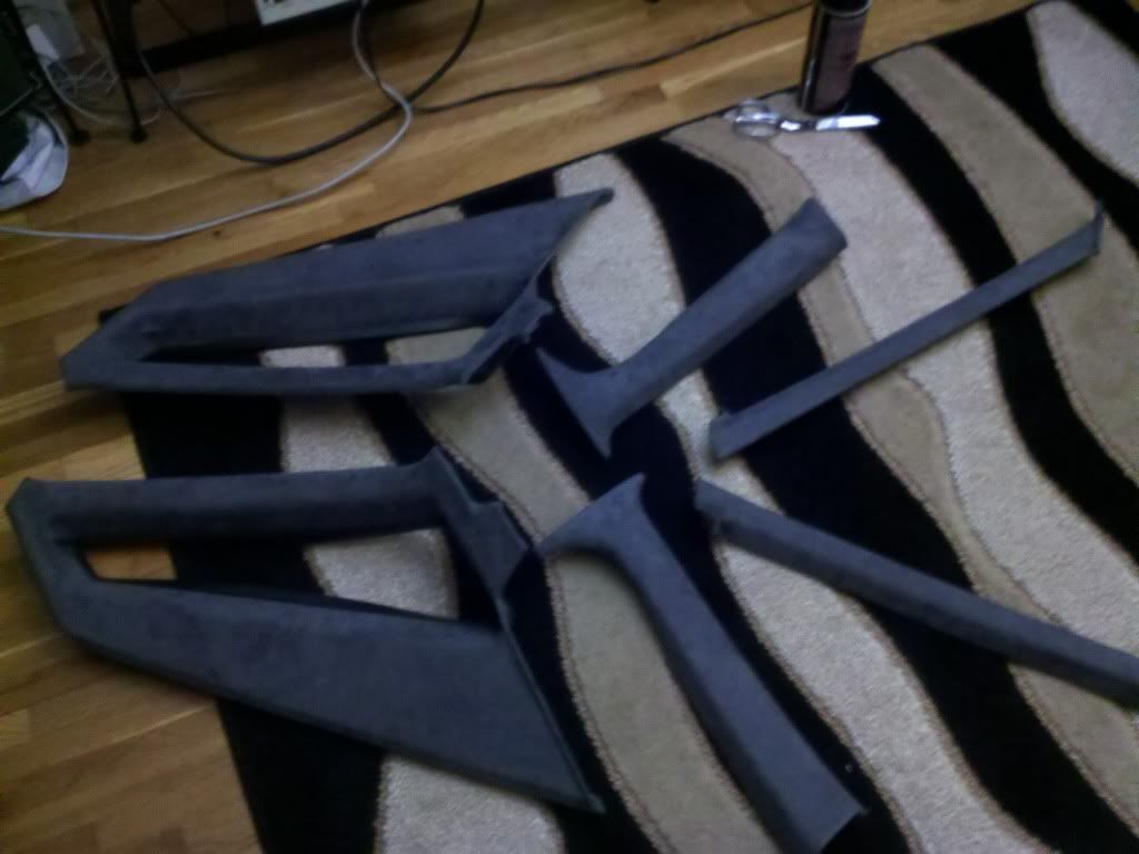

I did all the roof and side panels in grey suede and painted the dash and doorcards black
