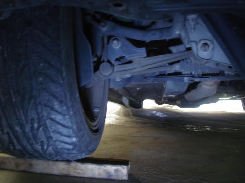

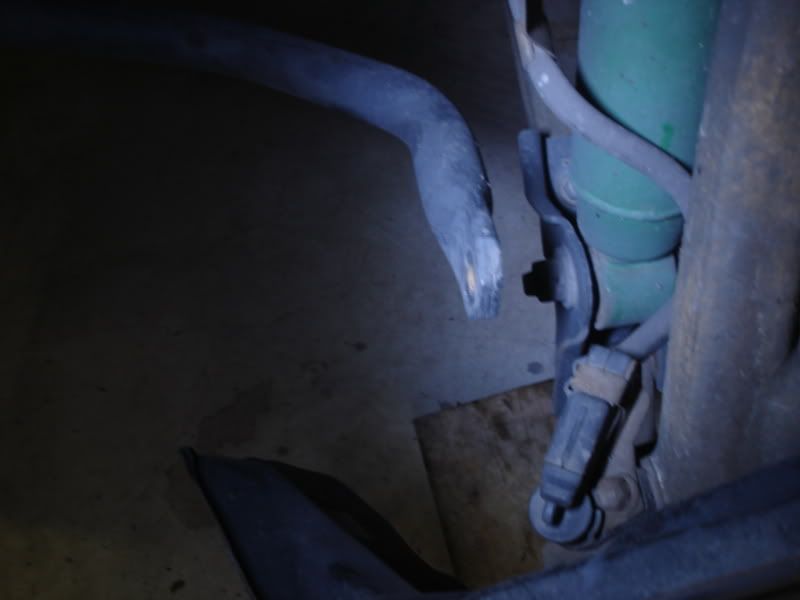

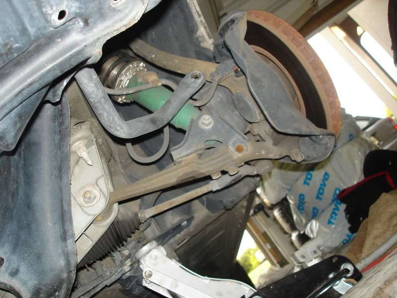

today i decided to jack it up and noticed the passenger side swaybar is not connected and is missing a peice.
first 2 pics shows what its missing and the last shows what it should be on the driver side.
anyone know if there are any other chassis that shares the same part?

Posted 10 August 2008 - 04:17 PM
IS300 probably has the same ones since that looks exactly like my front suspension.

Posted 10 August 2008 - 04:38 PM
Bill what year you think? something like 2003?
ill go to local Toyota dealer next week and see what they can do.

Posted 10 August 2008 - 05:01 PM
yeah IS300 should work; the IS has exactly the same suspension as the JZX90 it seams from your pictures.

Posted 11 August 2008 - 02:36 AM
well mine is an 01, but i think they are all the same in that area.
if the dealer is asking too much, try the aftermarket sources for front swaybar endlinks for IS300 before you go so you know your options. even if the dealer blows you off with a ridiculous price you'll have a back up option.

Posted 11 August 2008 - 09:08 AM
i'd go aftermarket anyway, these stock endlinks are prone to failure if you drive the car hard. mine need replacing already.

Posted 11 August 2008 - 03:17 PM
tks guys..... anyone recommend a certain brand of swaybar end links? any good sites? this JZx stuff is somewhat new to me.

Posted 25 August 2008 - 06:01 PM
well guys turns the IS300 is identical match and just installed it tonight! all is good!
