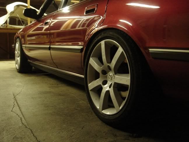

350z wheels
17x7.5 and 17x8 +30
215/45/17 and 215/50/17
I had to roll the rear lip flat and no change to the front.
Looks great for an oem wheel. Easy to fit and cheap ;-)
