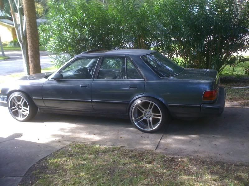

new_rims2.jpg new_rims.jpg i finallly got some wheels on mine! =) motegi racing 19x8 offset unknown (if any one has an idea on that info it would be greatly appreciated!) not crazy about the offset but i like the style of the wheel and the fitment is perfect! doesnt rub fender AT ALL (and my fenders arent rolled) and i have full lock w/ no rubbing! and it helps i got em on craigslist for $100 with 2 of the tires being brand new (falken 452 225/35/19) CAME UP! ( i think)
oh and just in case uve ever wondered what a cress would look like on 22s =)......donk.jpg donk2.jpg
