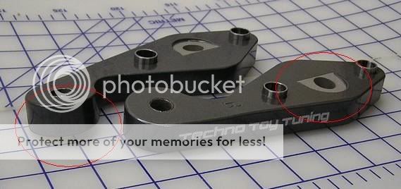

Just saying there is no angle a car being low does not make it need a flat angle as such
for example my car is running full custom sub frame in rear and runs LOW
just a rule with design as such something on a 8 degree angle lowering your car 3 inches does not mean you now will run 0 degree of angle if you get me. and for your information 326 ones don't go from a angle to flat they just remove a part and re-weld
i got tfreedom aftermarket knuckles on my car and the design is total diff to a flat laser cut item , so just trying to get around how these work even if you look at other items for s13 and so forth like drift work ones they are still the same design they just move everything up to keep the geo of a car the same as such
just my 2cents not having a go at you or anything just trying to work out design thats all

Hizoku, I was running theses in my ae with no issues and aw11, so the ones Mitch are running are prob gonna be GREAT! and a u can see the theres no angle.
#46 aphxero
  • 4867 posts
Posted 14 January 2011 - 01:01 PM
Yes there is. What do you call that in the middle?
To me it looks like there is angles in this to look at the one on the top it sitting normal but you can see it is raised up and if you look at where the strut would bolt to you can see this tapers down and is deeper near the centre

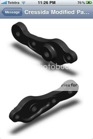

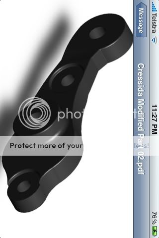

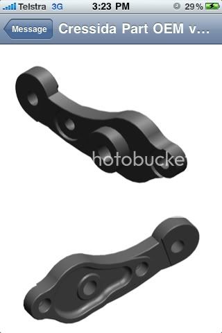

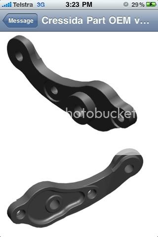

Those are not flat plate. Hav a look, they still maintain the angles where the tierod attaches.
These are the parts I have had designed. They will be offered soon. These where improved by an automotive engineer who said the angles should be retained. So I did not go with the flat plate like you have.
These will be made out of aircraft grade 4140.

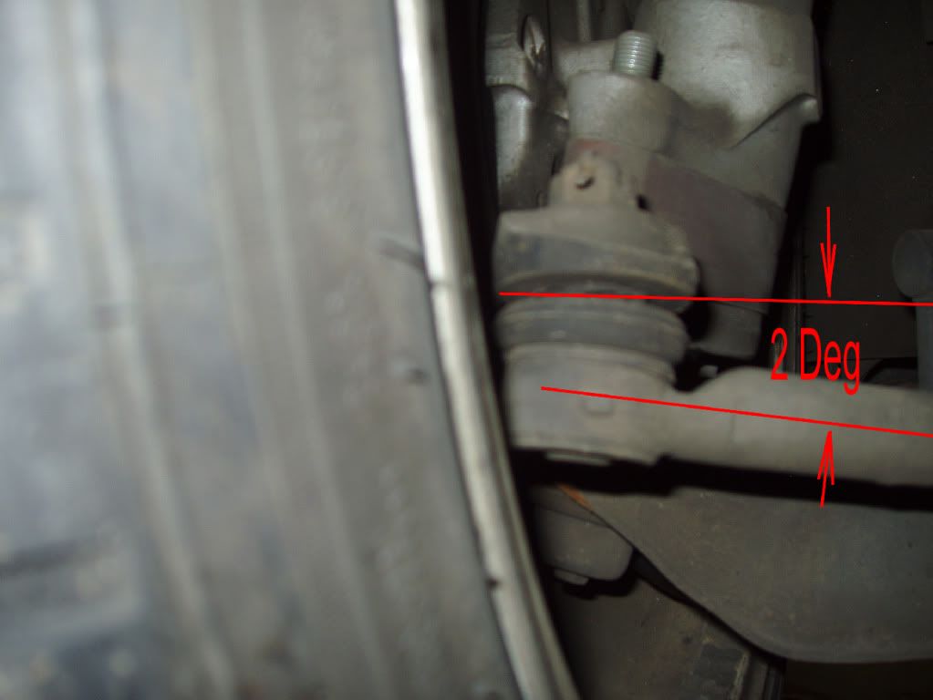

  • Interests:Money<br />bitches
  • Country:Sweden

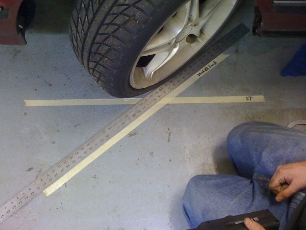

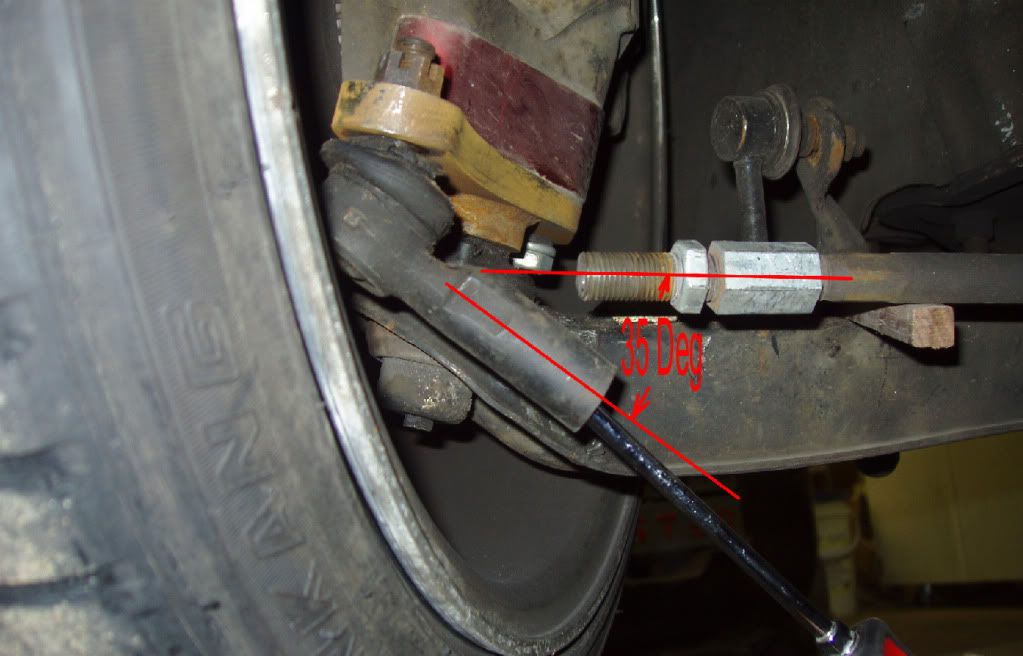

Posted 22 January 2011 - 01:20 AM
So we got some pics of the outer tie-rods. So these are ruff estimations of angle, but you can see that there is no way the tie-rod can bind.
There is about 55 degrees of total articulation. As see you the stock angle at the tie-rod will get closer to binding the lower you go.
The design of the Xcessive knuckles come no way near binding. Now if you were to stock ride height these will not work, but you should not be concerned with aftermarket knuckles.

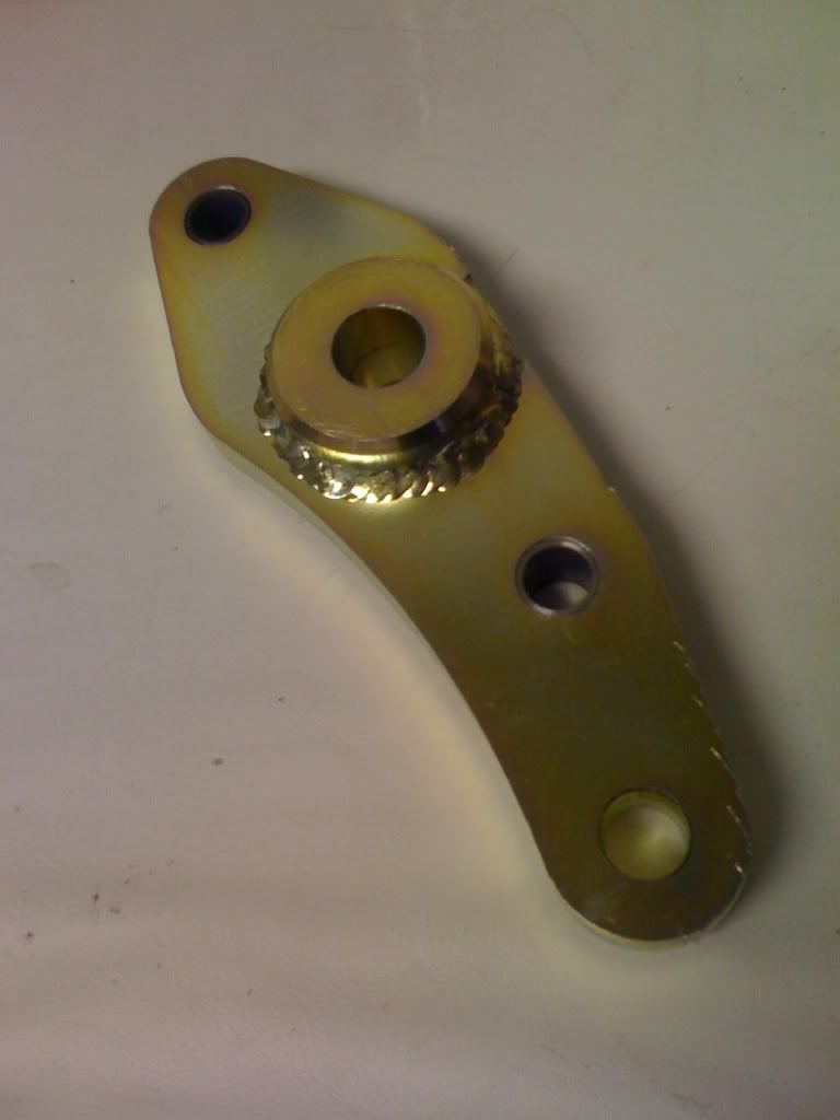

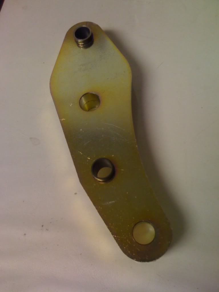

Here is the final version of the knuckles with gold zinc plating

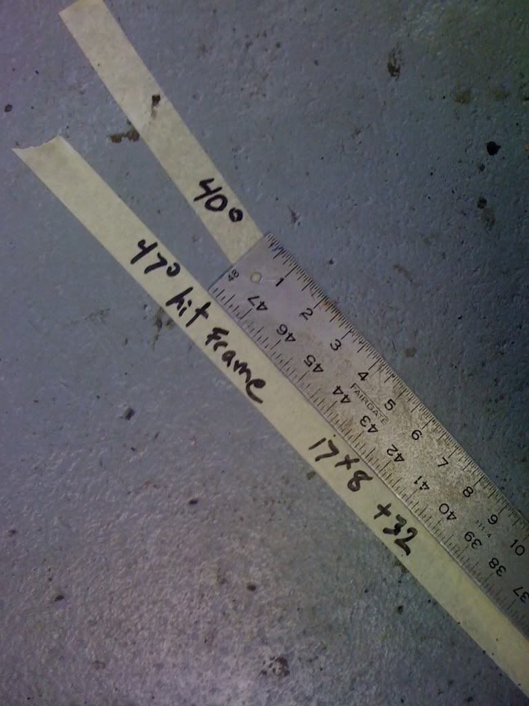

So we put the finished edition on Lucs' car today and measured the stock angle vs XM knuckles.
The stock setup get you about 40 degrees at full lock.
After the knuckles were installed the max angle achieved was 47 degrees when we hit the frame.
There is about a quarter turn left in the rack which should get you over 50 degrees of angle.
