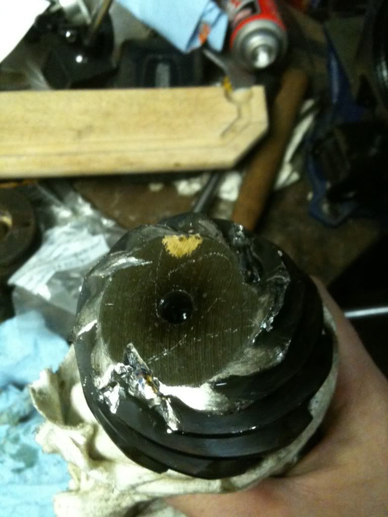

Posted 15 June 2010 - 08:45 PM
New diff and all bearings here, I'm setting it up and trying to get the gears patterned properly now. It looks like the next most likely thing to break is the ring gear or the actual pinion shaft.
This is what happens when your pinion crush sleeve collapses and your pinion gear pulls into the carrier.

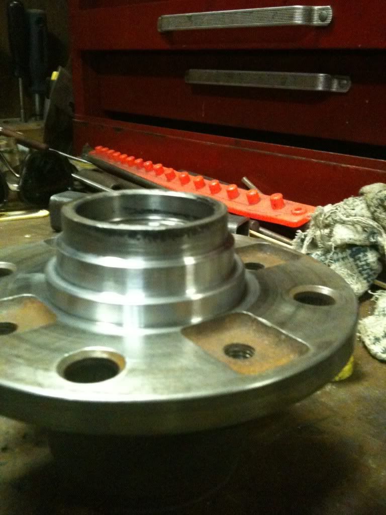

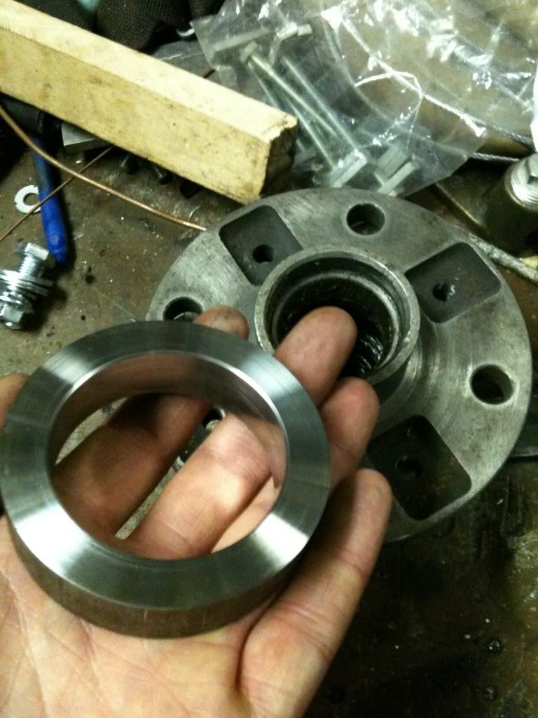

Posted 05 July 2010 - 09:01 PM

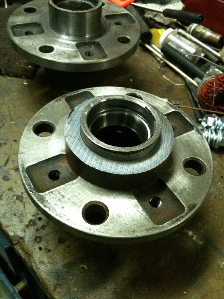

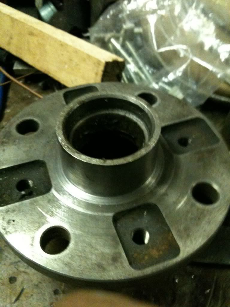

I did a bit of work today on my hubs for my 300ZX brake setup. I'm cheap, lazy and stubborn so I'm not going 5 bolt right now. Sorry about the crappy iphone pics.
Machined hubs (diameter machined to fit inside the rotor hat, snout machined down for thermal fit ring)
Ring ready to be heated
one hub ready to go in the freezer and one with ring installed (.002 interference fit)
finished product
Should be installing them this weekend.

The 7.5 inch stock LSD is trash. My problems have been mostly from the crush sleeve collapsing and the pinion smashing into the diff. According to a lot of the mk2 supra guys even with a solid spacer the stock diff is only good to 300-350 horse/ft/lb before you'll shatter the spider gears, and the TRD unit isn't much better. I put in a detroit truetrac and a Weir Performance solid pinion spacer, so far it's awesome, and it's the one 7.5" diff that is supposed to stand up long past the point where the ring and pinion fail. It's helical but it still gets sideways pretty well. The last guy I know of that broke one in a mk2 supra was running a 2J pushing 700+ horse and was running slicks.
You can't fit an 8" diff in an MX73 without MAJOR modifications, like a completely custom rear subframe..
The first diff I blew up was low milage and I was only running 10psi. The second one was higher milage but still in good shape and I was being semi-nice to it when it shat the bed. In short, they're junk. I don't know anyone who's used the weir rebuild kit, but it won't change the fact that the spider gears aren't very tough.

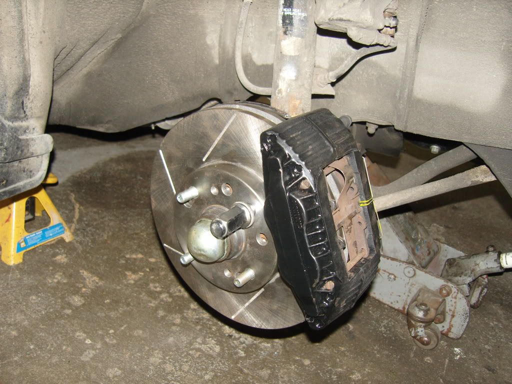

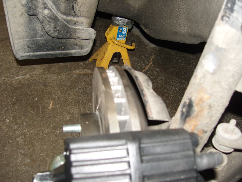

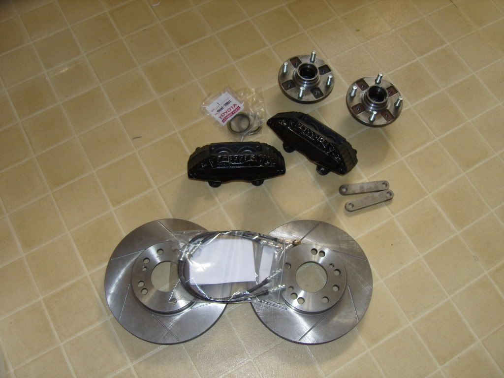

Posted 08 August 2010 - 12:54 AM

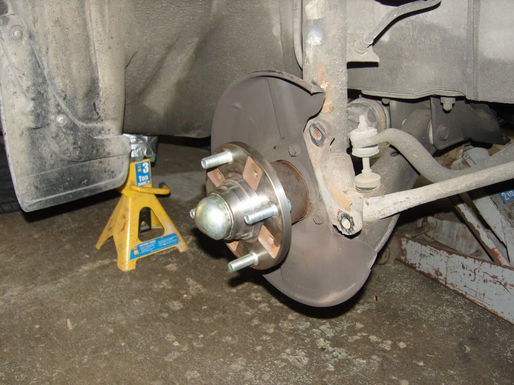

I finished putting on the 300ZX brakes a couple weeks ago. They stop really well but I think I'm eventually going to go to a bigger diameter master cyclinder for better pedal feel.
redrilled rotors, rebuilt calipers, PDM racing S13->300ZX braided lines, custom machined hubs, 10mm caliper spacers and new hub seals
I had to trim about an inch of the front of the brake shields to clear the calipers
the brake shields clear the rotors by a few mm.

Posted 08 August 2010 - 08:03 AM
what wheels are you running? how do they clear?

Posted 08 August 2010 - 08:07 AM
Sadly I'm a broke bastard and am running stock wheels. They clear by around 5mm.
