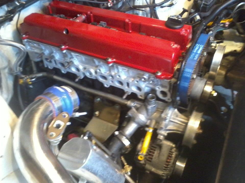

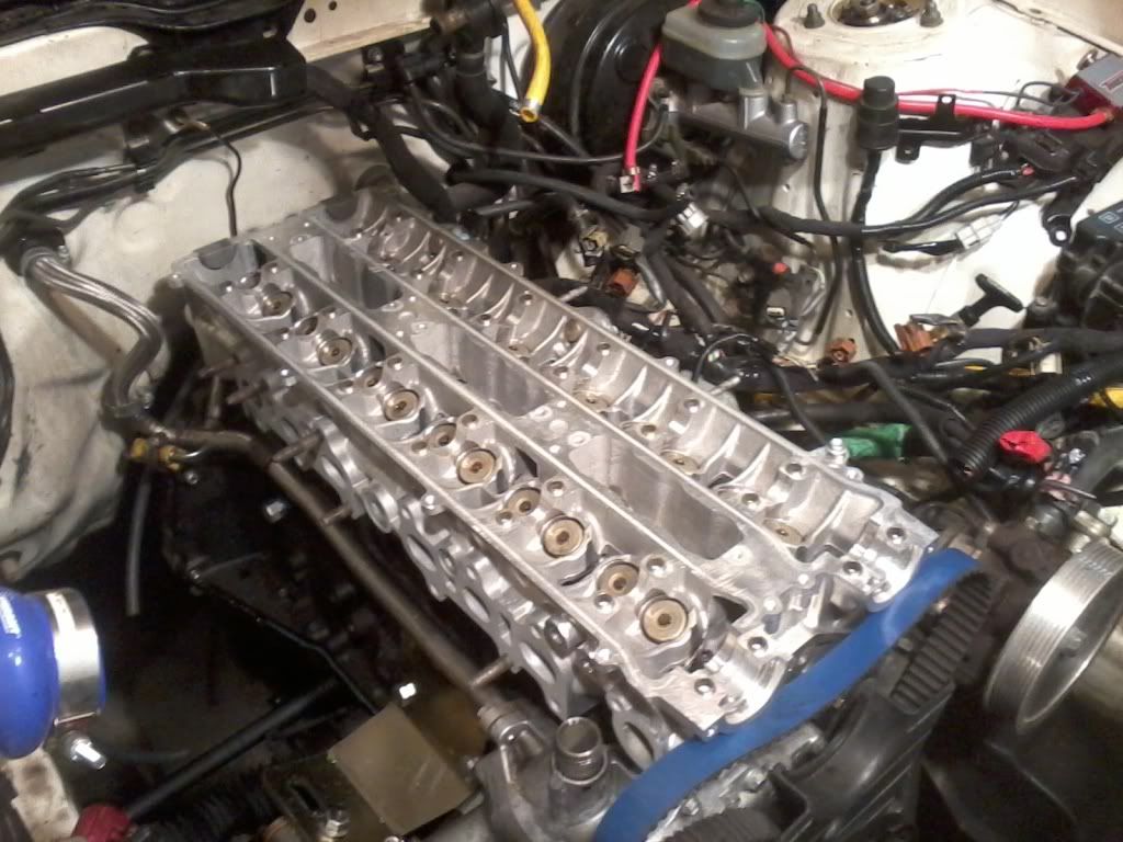

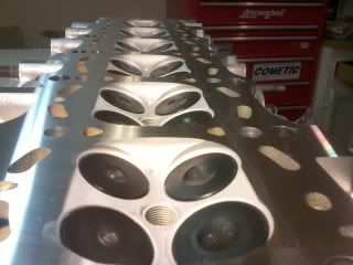

So I spent all week putting my head back together.
- 3 angle valve grinds
- machined new seats
- new guides and stem seals (felpro)
- ARP head studs
- cometic head gasket
- new exhaust studs, nuts
- new toyota oil filter, and toyota red coolant
I put everything together. Went to fire it up and the starter didn't work. So I pulled the starter, tested it, find out it's crapped itself. So I replace it with a new starter turn the key and the engine runs like shit. Tons of smoke and fuel and its backfiring and popping. After chatting with other jzx'ers i'm thinking, me being a blonde, I never checked my shim clearances. What was I thinking. My timing is bang on. I might have the injector clips wrong, but regardless, I gotta check those shims.
I should've just levelled the head and threw her back on valves rattling away, out of spec. And replaced head if it gave me problems. She ran fine before minus the coolant leak.

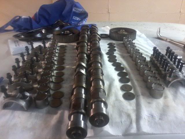

Posted 24 April 2012 - 07:09 PM
Just checked my shim clearances and all of them except one will not allow my smallest feeler guage to go under it. How the hell do I know what sort of shim to order if I can't get any measurments. If I would have known all of this before I was advised by my machinist to have my valves machined, I never would have done this shit.

Yeah, i'm starting to wish I did. The exhaust valves were way out of spec, you could move them in their guides and the valves wouldn't hold air pressure. At least this way i'll have a solid head. So i'm going to go to the junkyard and start pulling shims out of heads to get some smaller sizes. I gotta grab an electric fan setup while i'm at it anyways.
* Next time just add lapping compound and seat your own valves*

Go shimless? I believe 3sge buckets or something like that make it so you don't need to run shims. I know the poopra guys do something like that all the time when running big cams.

I've actually been looking into it. Once I get the proper measurements I may just order up some 3sge shimless buckets. Apparently this will remove 12 or so ounces and translate to a smoother running head at higher rpms. If I ever decide to cam it , this would be ideal.

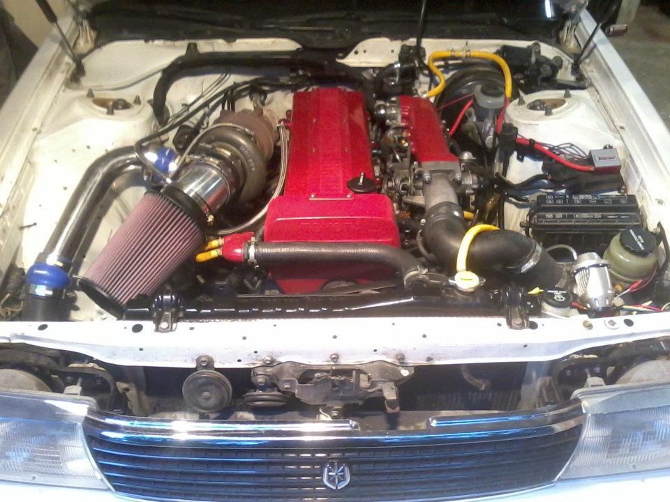

It was a gongshow to re shim the head but now it's done.
2 Years later , several thousand dollars, countless fights with my girlfriend and hours slaving away, throwing tools , feeling like the project was a big fuck hole of fail....
..... It was finally finished.
It runs amazing. I Put a new IACV on, and it idles bang on 1000rpm. I wired my tach exactly how aphexero's thread said too, it works perfect. I cleaned up the wiring in the car. Right now i'm running the exhaust straight out the down pipe. My neighbors love me.
I went and pulled twin electric fans from an altima and wired them up. They fit perfectly. One of the top bolt holes lines up perfectly and the rad drain cog, helps hold it into place. Other than that, all you have to do is drill a couple of small holes on the side of the shroud to line up with the holes on the side of the rad, and pull a few zip ties. Cheap $50.00 solution and it makes my rad 'stay frosty.'
The only concern I have is that the clutch is slipping when I boost around 9lbs at 5k rpms. I'm worried that I didn't break the clutch in properly at first, I couldn't hold back and did a few hard pulls with it at first on a brand new 6 puck and flywheel. I know, that was really stupid.
I'm going to try adjusting it, and if that doesn't work, do the e-brake clutch de-glazing proceedure. If it doesn't work fuck it, i'll just drive it like that until the end of the year when I pull the engine at the end of the season.
